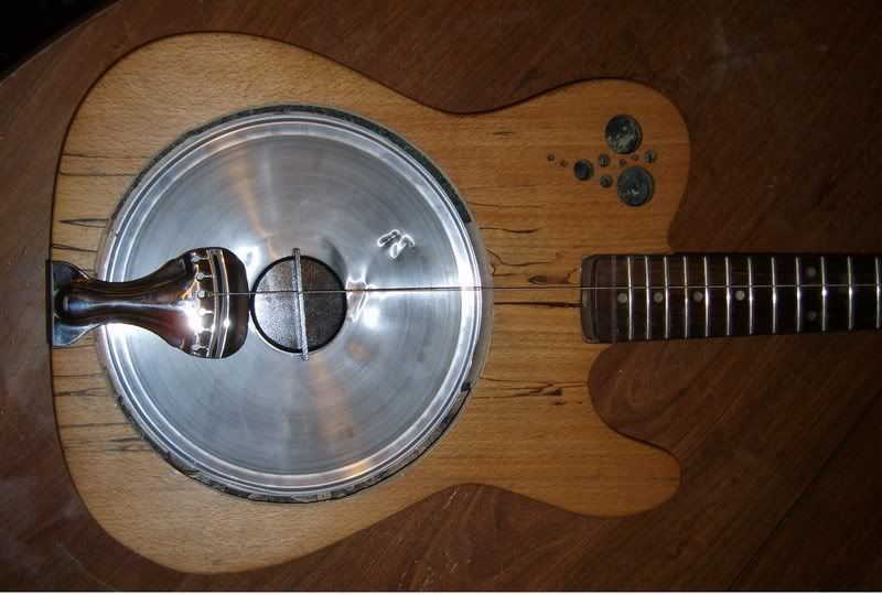

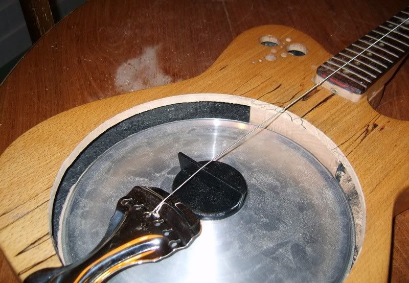

 i decided it was time to do a reso electric experiment and have just spent the evening routing out for the cone
i couldnt resist throwing it togther so grabbed a neck (which doesnt fit) and added a string.
here it is at the moment

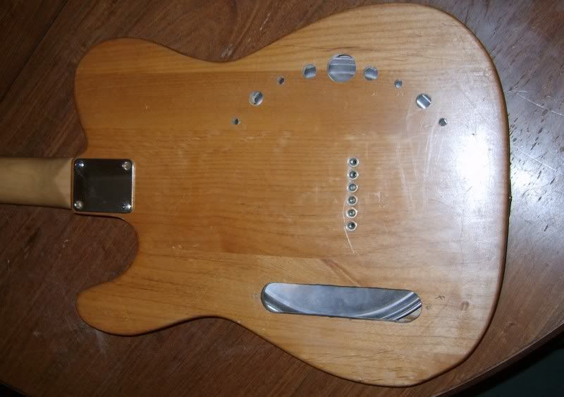

i also decided to add a few holes to the back, since the cone is set into the back of the guitar i thought they might help the acoustic sound
Well, i think i am going to have to spend a bit more time on this because my initial impressions are pretty damn good!!  It sound like a quieter resonator which is better than i was hoping for at this stage

I suppose everyone has noticed the dents in the cone - it came like that but the supplier are already sending me a replacement.
Obviously thanks go out to sollophonic for the great idea.  I want to do a proper reso at some point and this is a great introduction!!

Does your tele have a neck angle?  We've been slightly redesigning the metal reso's that we're building and trying to increase the break angle over the bridge.
Quick and dirty project - resoelectric
« Reply #12 on: November 01, 2007, 12:19:25 PM »
it has a 2mm shim in the neck pocket at the moment to create the angle - i will do more work to get the angle right once i have a neck that fits!!
