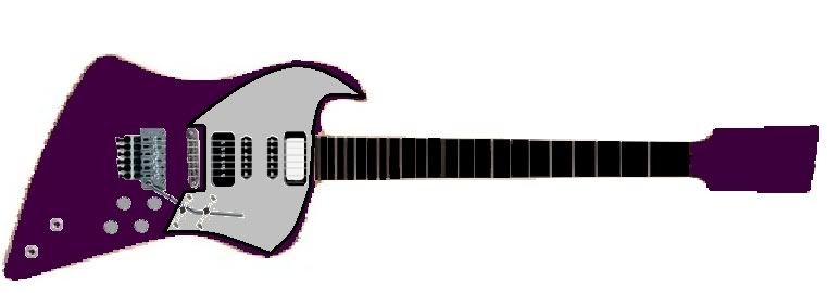

This is (hopefully) the end product

an advantage i can see is that it makes intonation and action adjustment a lot easier since that would be handled by the tune o matic, rather than the fiddly (and very frustrating!) Floyd.
a disadvantage is that it maybe puts the actual whammy bar quite a long way away from your playing hand.

Please post pictures so we can see what it is like and what the workable options might be in reality - makes the speculation much more possible

I agree with jonathan - giove us some pics of the current state
