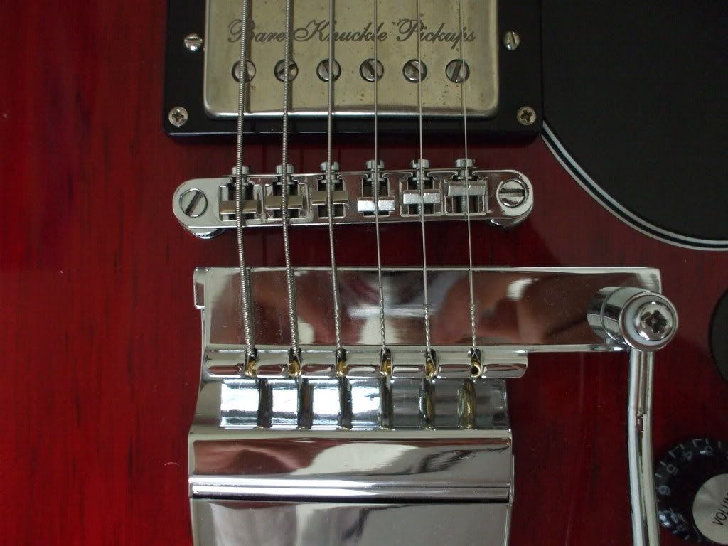

I restrung my guitar today and noticed that part of the vibrola has slipped downwards making the strings wonky.
I've tried taking the bar off and using a mallet to lightly hammer back but it didnt budge.
Does anybody know how it can be pursuaded back into place??
Re: Meastro Vibrola Expertise needed :s
« Reply #1 on: September 12, 2008, 02:36:12 PM »
On mine, it slides freely when the strings are loose.  Slacken them all off, adjust it, then tune the bass E to pitch again holding the vibrola steady.  Then tune the other strings.
