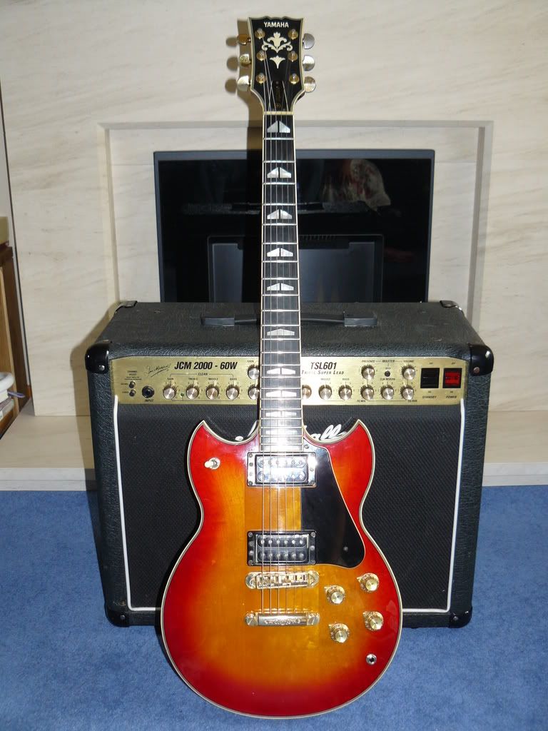

The first thing I'll say is that I love the guitar to play. It has a solid but slick feel to it, helped no doubt by the ebony fretboard.
I'll also say that I like the sounds that the stock neck pup gives me. It isn't a hot sounding pup but has good clarity and sounds very nice when it's coil tapped. Sort of like a warm Strat in position 3.
My issue is with the bridge pup. It is just too lightweight sounding. It's not just that it's too bright. It lacks  ... body.
So ... that leaves me with the choice of replacing the bridge only or both pups and hope that I can get a BKP neck pup that sounds similar to the stock neck.
The guitar itself is a mahogany back with maple top. It has a mahogany and maple neck through with an ebony fretboard. It also has an under-bridge brass sustain plate. The guitar appears to be set for 9-42 gauge strings and it weighs 11.5 pounds.
The SG2000 is known as a guitar with more treble characteristics than a Gibson Les PaulStandard . What I don't know is if this is due to the stock pups, the build design or a combination of both.
What I'm looking for in this guitar is to use it primarily for lead work. Ideally I'd like a bridge pup that has a warm bottom end and rich mids with enough treble to make it sit well in the mix.
I'd like the neck pup to be similar to the stock pup - as described above but perhaps a little warmer.
Style of play that I'll be using the guitar for is leads similar to Gary Moore, Dave Gilmour - kinda old school rock stuff.
One thing to bear in mind here is that I already have much of what I'm looking for with Emeralds in my LP. I just want more of the same but with more emphasis on warmth and smoothness. The Emeralds are excellent because they have a crisp bite to their tone - making them great for aggresive solos.
There we have it. Am I asking for too much here?
Oh yeah ... I also want black covers with gold poles, to keep the original look of the guitar  :P
Here's the guitar.
