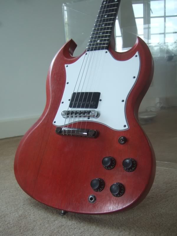

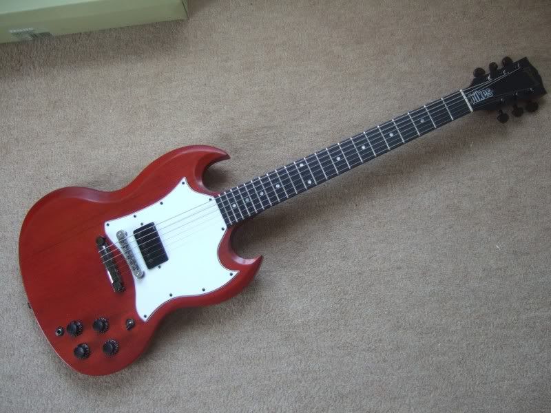

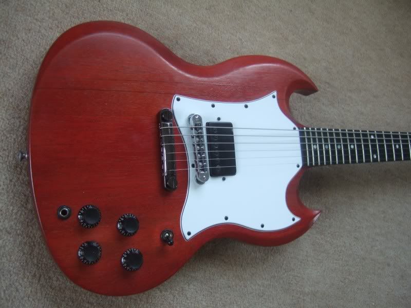

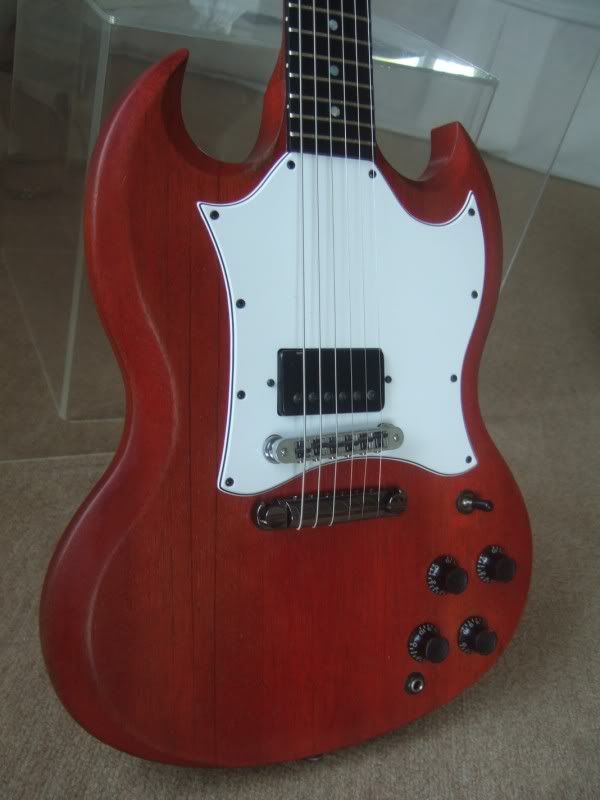

Incase anyone is interested, here is what my SG looks like now.

« Reply #11 on: June 29, 2009, 03:52:10 AM »
cool
those faded models are killer guitars
just sold one, but I still have another one
most resonant SGs I've seen
great neck feel and stability too
