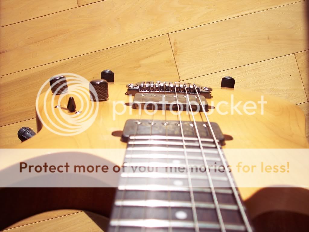

After patiently waiting for the opportunity to get these to a tech to install them for me, and the consequent days for him to get around to it, I get this back:
So, if you didn't see from the boxes, I ended up with a Painkiller in the bridge and a Cold Sweat for the neck; Nick recommended a matched PK set, but after all the raving I heard about the CS, I couldn't pass up the opportunity to try it. After having the chance to play it, these are my impressions:

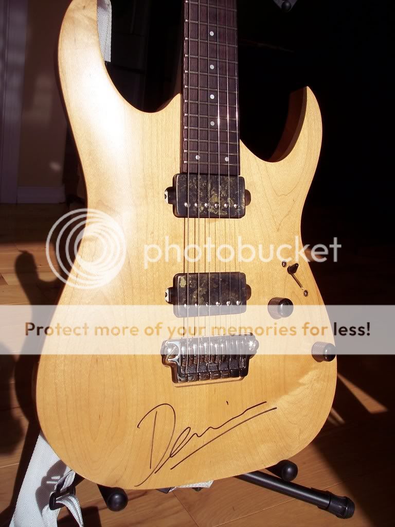

Not only so they sound amazing, but look it too. The custom distressed camo covers, normally found on the Nailbombs really make this guitar look amazing (not that it didn't already). I suppose this is about as close to Blackmachine as you can find in a production guitar in terms of looks, and these covers made it that much closer. And the best part...NO ROUTING NECESSARY. I suppose some of the folks that have this model that did have to may have had an older one or something (or the model that has a veneer on the headstock).

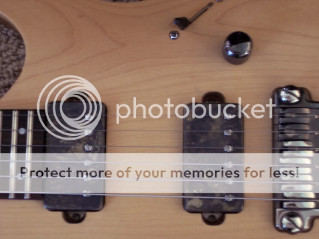

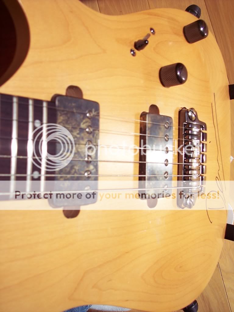

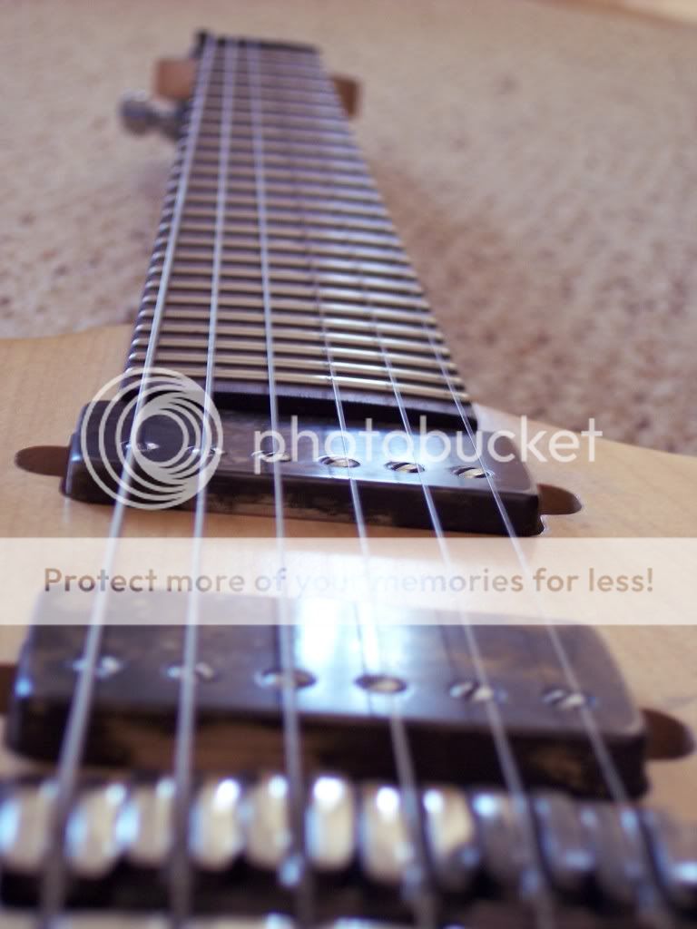

P.S. Anyone know what's up with these pups and the wiring for this guitar in particular? (RGA121) The tech I took it to went and got a wiring diagram directly from Ibanez and tried to match the one BK gave me to it and had no luck getting position 4 (previously parallel neck 'bucker) to work at all and position 5 had to be either full hum or a sc...Right now I suppose I can use it as a Kill Switch, but I'd really like to give the Neck SC a go. Anyone have experience with this, or should I contact Tim direct?
I haven't the slightest clue as to what the position of the pickups is supposed to be, but I've had several people inform me on other forums that the tech installed the neck pup upside down.  Now, he's not new to the business or anything, and I'm sure he's worked with covers before, so I doubt it's a mistake on his part.  I assume he left it like that as it was how I "placed" it in the guitar (to see if they would fit without routing).  He said if I figured it out after getting some help from you guys or Tim, he'd fix it for me...so I'd appreciate any insight you all have.
It works fine and sounds great, but is it supposed to be the other way, with the pole screws facing the neck?  If so, is the fix as simple as unscrewing it, flipping it around, and screwing it back in (i.e. no wiring changes?)

Cant remember BK wiring codes off the top of my head, but they arent hard to find, they certain should be wirable as-was, so long as they're 4 conductor
The neck is, traditionally speaking, upside down. The bridge isnt. Screws are nomally on the outside (closest to the neck and the bridge). That neck will currently be a little bit brighter than it would (for the same height) if it were the 'right' (traditional) way round. Manys the time I've put pickups in the other way round to get the different sound of them though (neck, its a little sharper when flipped, bridge is quite a lot bassier if the screws are further up the string).
And yes, if you want to change it, just unscrew them and flip them round.

Cool, thanks for the heads up on that.  I do tend to like my lead tones a bit more bright than this pup is putting out atm, but it still sounds fantastic; I'll probably follow your advice and flip it to get the sound I'm looking for.
I'll probably end up contacting Tim about it, seeing as how he genuinely seemed confused as to why it wouldn't wire up like is "normal."

neck pickup definitely upside down, first thing I noticed when I looked at the pics. Sack the tech.

Hot lookin' ax.  Congrats.

Thanks mate, love the look of bare wood, and the covers really do make it that much more visually appealing.  Definitely worth it being that you can pick one up for between 400-600 bucks used.
