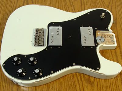

Related to the other Road Worn thread...
« on: July 16, 2010, 02:00:37 AM »
I did it....

« Reply #1 on: July 16, 2010, 07:41:26 AM »
I know where that came from!  :lol:
Nice one.  Are you going to get the matching neck, or something different?

« Reply #2 on: July 16, 2010, 07:55:20 AM »
and another tele hit's the board!

« Reply #4 on: July 16, 2010, 01:25:10 PM »
All the "big boys" only have black left. There are a few Customs out there though.
Although I did find a couple white ones online, there was nothing close where I could actually play one.
Knowing that there are two major things I would change and a couple of minor bits as well, this seemed to be the best way to go.
Neck is ordered. USA Custom Guitars 22 fret, CBS head, 14" radius 6100 SS, 1-11/16" nut.
Two piece maple/maple
Warmoth "humbucker spaced" (2-1/8") Strat hardtail. This bridge will bolt right on to the existing holes. String passage will have to be opened up a tiny bit to accommodate the spacing.
Maybe later when I get a little time I'll put a Floyd on this one...  :lol:
I'll try the wide range hb's, these could be subject to change rather quickly.
Electrosocket jack and Kluson tuners.
Neck will be oil over brown shoe polish... :D
Edit: Oh, and a Glendale Guitars Extreme fat neck plate, four bolts.
Straplocks.
All told about the same cost by the time I'm done.

« Reply #5 on: July 16, 2010, 02:29:20 PM »
Sounds good, looking forward to the pictures!
