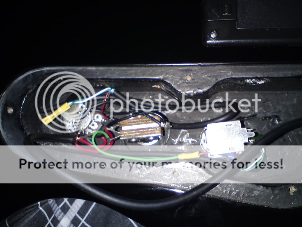

« Reply #8 on: January 14, 2012, 03:28:50 PM »
So here's the guts. Aside from the neck pickup not connected of coil splitting, how's it look?

« Reply #9 on: January 16, 2012, 09:15:56 AM »
I don't see any obvious errors - from what I can see from this picture the bridge pickup's red wire has been extended with the green wire and covered with the yellow heatshrink. The green and white are soldered together and go to the push/pull pot for coil tapping, right? I cannot see where the black wire from the pickup goes - it should go to ground but I guess it does - otherwise you would not get any sound.
The wiring may not be pretty but mine is not necessarily better. Especially I do not like to cut the wires to length - I may bite myself later if I want to swap pickups and have to extend them again.
I would rather suspect the guitar than the pickup for the difficulty of getting pinch harmonics. To be sure you could swap the Nailbombs over to the SG and the Miracle Man to the Les Paul. I would imagine that the LP still cuts and the SG will still not cut it.
BTW: what bridge type do you have on the SG? It may be worth considering an upgrade here. I just swapped some bridges during the weekend and the tonal differences on seeminly alike looking bridges was astonishing.
Cheers Stephan
