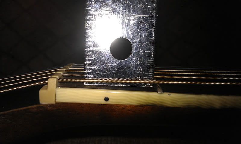

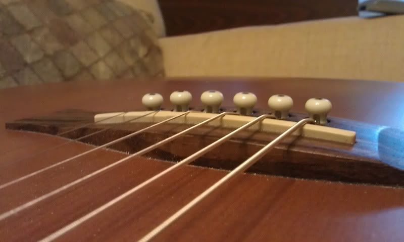

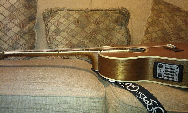

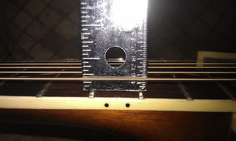

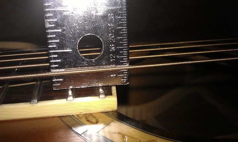

Here's some photo's.  I don't know if they're much help to anyone.
* sorry, could only find a steel rule with imperial measurements.

question.....why are bridge pins so high up?
looks like the top of sound hole sunk in little...not too bad..
here are my measurements the way you took the photos
1st fret = 1/64"
12th fret = 5/64"
20th fret = on top of 6/64" line
i do not believe the truss rod will effect the higer frets that sunk in a little.
press the 1st and 14th fret......u should have 1/64" under the 5th fret..(use a capo or ur 3rd arm.. :D)
adjust truss if needed.  only 1/8 turns......dont worry....u wont damage anything....
use a marker to make a mark from your starting point so you can always go back and can measure your turns better...
people turn these things a full turn and more and f#$k things up and wonder why.......
u will be fine...
the thing that you need to pay attention to is sanding the bridge nut....
too much and you will buzz
not flat and you wont get the most surface contact to the saddle...(more contact...better vibration)
its not hard, just go slow...
if you do take too much......I use the bottom of matches to bring it up a little.
from the looks of the photos, you prolly just need 1/64" off the bridge nut...
if you really want to get into adjusting tone...the bridge pins are cool to play with......wood...bone....brass...etc...
i know a couple fellas that like a lot more bottom end so they have E-A-D with brass pins and G-B-E with ebony..
seems to work...
