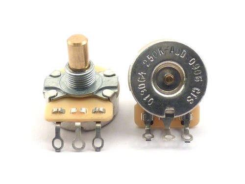

I'm pretty sure that BKP pots are simply CTS pots. The difference being the value difference of 50k. The tolerance is generally +/- 10%, but CTS will select pots within 5% tolerance for manufacturers with specific needs. The 550k pots don't roll off as much treble, so the effect of"having a blanket lifted off the speaker" is the result. Added clarity is a great thing. When I buy pots in bulk for my amplifier builds, I sometimes test the values to  tailor the sound by using greater or lesser treble rolloff. It's surprising the effect you can achieve with such a simple thing.
i am pretty certain i read that too.
and indeed, being at 550k instead of 450 will add clarity.
AFAIK there's a bit more to it (have heard that these "BKP" CTS pots were a bit less stiff).
Not sure about that, as the four 550K that are on my LP are pretty stiff compared to anything I've used. The tapper (spl?) is good and all, but turning them is not as effortless as my other guitars, being them emg pots, squier pots, ibanez pots, allparts pots, epiphone pots, etc.
Just a matter of getting used to them, I guess.
Mine are far looser than the stock Gibson pots.
Edit: Scratch that, my volume pots are BKP 550k and they are rather stiff. My tone pots are CTS push pulls and they are very loose.

I haven't tried the BKP 550k pots, but I find with CTS pots generally, the type with a "scoop" in the back are looser than the more common flat-backed type.  I much prefer the first type!
I meant "a bit less stiff than run of the mill CTS" - which are really really stiff :lol:
