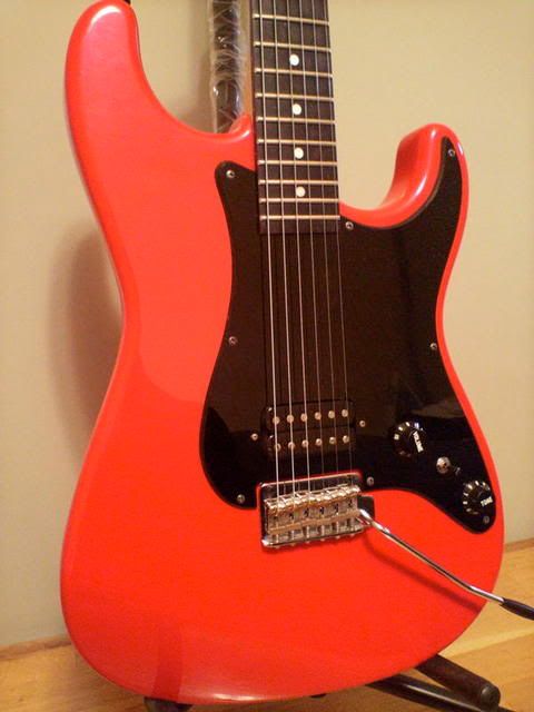

Today I picked up a Fernandes clone of the Charvel Allan Holdsworth model, it was made in 1985 I think but can't find it in their catalogue of that year.
It's not a particularly accurate copy; Alder instead of basswood, the neck is chunky but not as huge as the original, no skunk stripe and a Gotoh 1088 instead of the DiMarzio vibrato... But., I think it looks the business (It's very RED!), it's comfortable, sounds pretty good and it didn't cost the earth.

This is my first non-floating trem guitar and the bridge clunks against the body when you let go of the arm, is this normal?

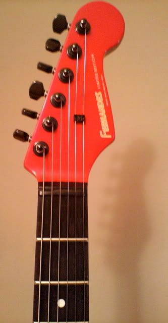

Also I think the nut is cut poorly as the D, A and low E are closer to the centre of the fingerboard than the high E, B and G.. you can see them in relation to the fret marker.
I presume this isn't normal as the locking nuts on my other guitars have equal spacing between strings and the same space from the edge of the fretboard on both high and low side. Neither of these have a big effect on playing but I am a nitpicker 8)

Quote from: gingataff
Yep.  If you slacken the springs a bit or fit heavier strings, you can set it so the back of the trem is raised above the body when it's at rest.  At the moment you have an "EVH" setup!
I've seen some guitars where the nut is cut so the gaps between the strings are equal - so the bass strings end up slightly further apart (centre to centre) than the treble strings.  Or they may just have cut it badly.  :wink:

Quote from: Philly Q
Quote

I've measured the distance from the edge of the fretboard to the centre of the nut slot and the low E is 5mm whereas the high E is 3mm, this difference continues with each "pair" (A&B, D&G) so I think I may get around to having a graphtech nut fitted sometime. I've also been looking at KTS Titanium bridge saddles and DeTemple Titanium Trem Block...
