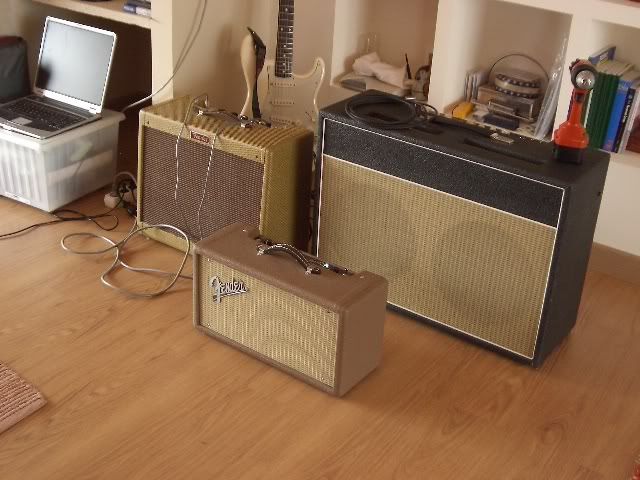

I know most guitar players really  like reverb as it helps getting a very special, richer touch.

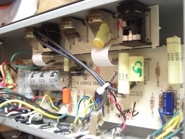

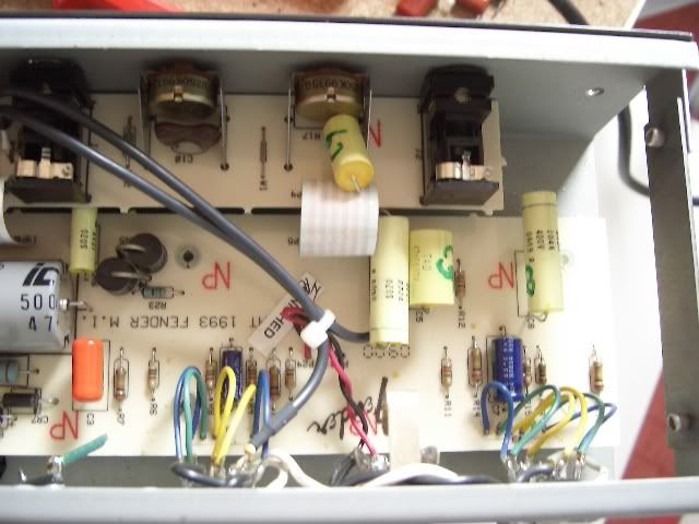

With that purpose I've found that the Fender reverb tank is a nice effect but more so with some mods I've performed.

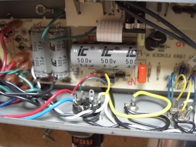

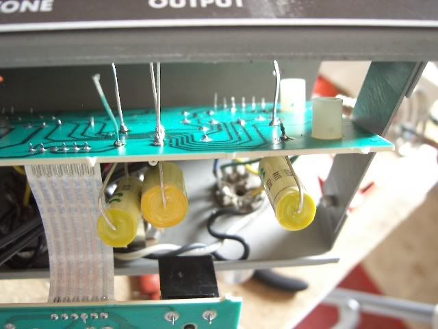

I had a look inside and I noticed some very so-so looking coupling caps... uhmmmmm... time to plug the soldering iron in. ;)
I got some Mustard type caps (Sozos and  TAD ). They sound fairly smooth and a bit darker than others like Auricaps which are sooooo transparent. I've found out that that very slight dullness is not bad in such circuit. I used an Orange Drop in one slot as I didn't have a mustard type cap for that particular slot there and then.
The infamous C10 cap was cnahged for a silver mica type and following Mike Fuller's suggestion I went for a much bigger value  than stock ( 250 pF ). I used a 1000 pF which sounds better to my ears.

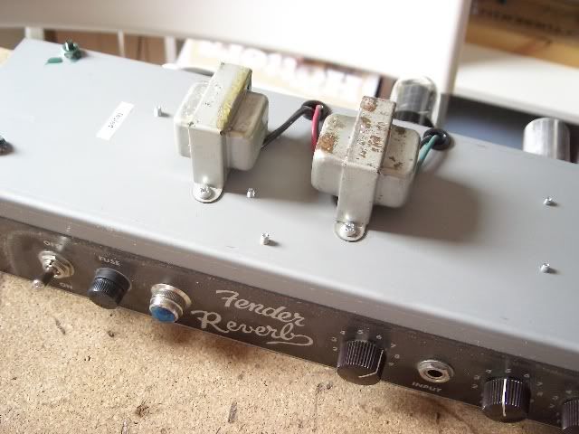

The output tranny is a Mercury Magnetics replacement as the original looked and sounded weak.
Some pics;
Any comment will be greatly appreciated....

I've always fancied one of those outboard reverb units - I'd be temped to rip the PCB out and hardwire everything with a turretboard, it's a fairly simple circuit afterall.
What tonal difference did the MM trannies make?
(not having the schematic to hand), I'm guessing the change of cap from 250pF to 1000pF sets the EQ of the reverb???? - if not, what DOES it do?

Yes it's only a reverb but it shapes the sound a bit like a preamp does. Highly recommended for vintage clean sounds. MM stuff is a bit expensive but sounds fantastic ; all my amps have them except my JTM45 clone which has an obsolete electronic OT which sounds very sweet as well.
HEAVIER THAN HELL,
The MM tranny made the reverb deeper and richer but keep in mind that I changed the caps at the same time so it could be a combination of both. There's a little bit less boing and rattle ( well, it happens at higher settings ) which is a good thing.  To my knowledge the C10 cap controls the frequencies affected by the reverb ... the higher the value the deeper the reverb affects the frecuencies , especially the low end.
Mike Fuller enjoyed a 0.002 uF ( 2000 pF ) plastic cap there. It ended up sounding like a plate reverb.
LOL!!!
BTW, I forgot to mention that I used NOS valves as well.... Marconi ECC83, Mullard ECC81 and RCA 6K6GT.

« Reply #11 on: April 26, 2007, 09:49:06 PM »
Quote from: Ratrod
So you have a customized reverb tank, a tweed amp and a Strat. I'd say that calls for a surf clip.  :D   8)
Unfortunately I play fingerstyle so surf  guitar playing ( at least in the most orthodox way ) is out of the question....

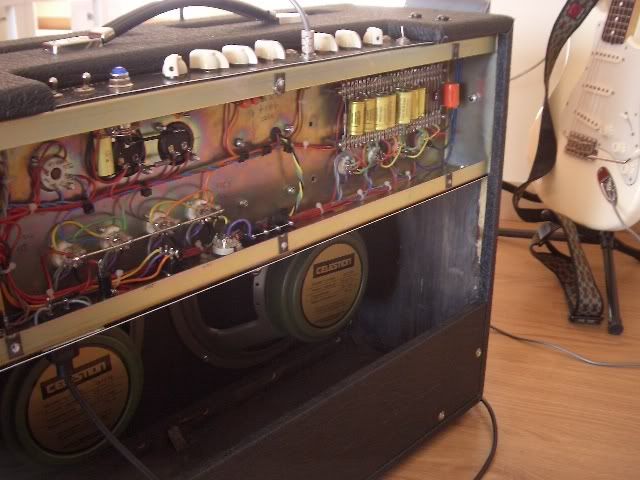

BTW.... these are the guts of those two mice amps next to my reverb. One is a tweed Deluxe clone and the other a very much Matchless DC-30 clone.
None of them are mine ......
