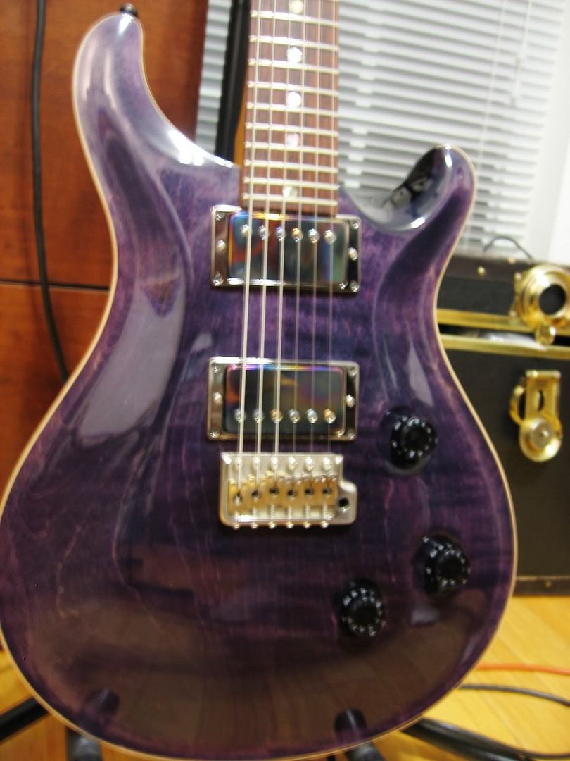

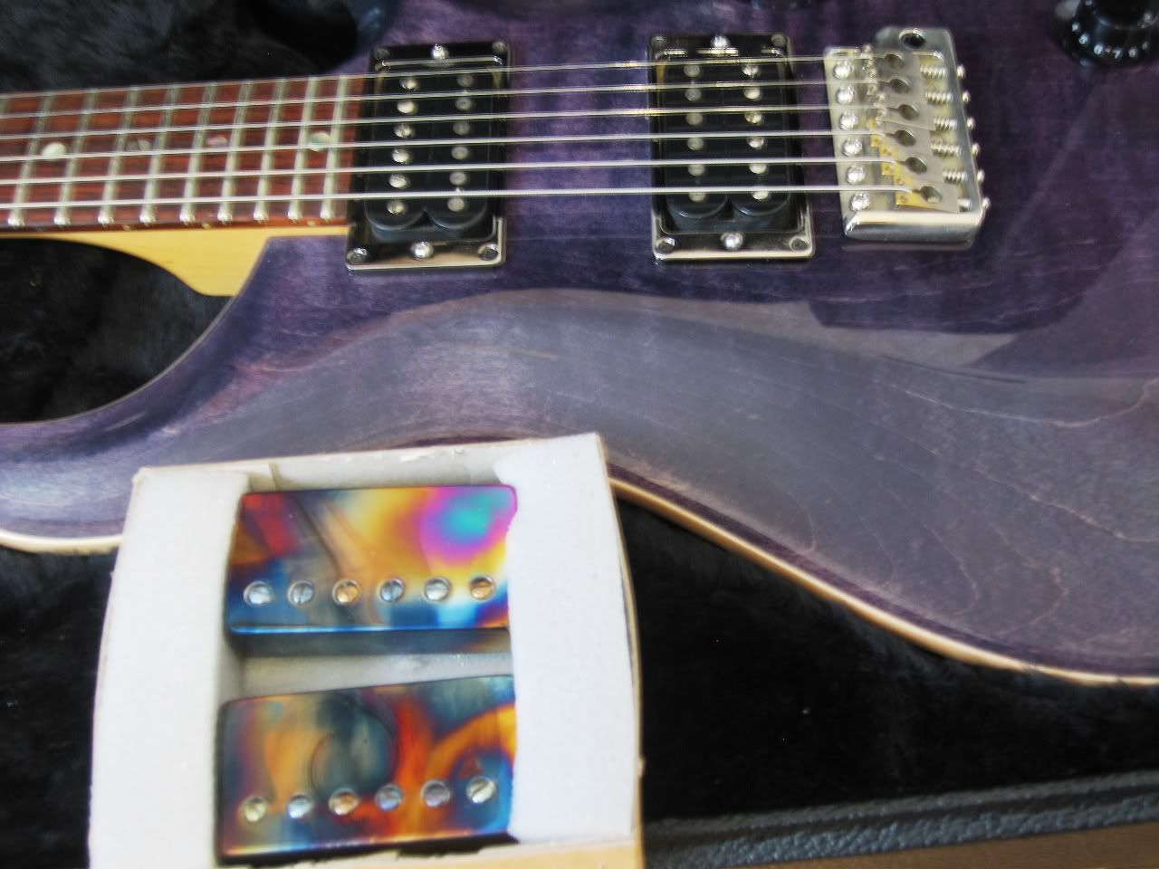

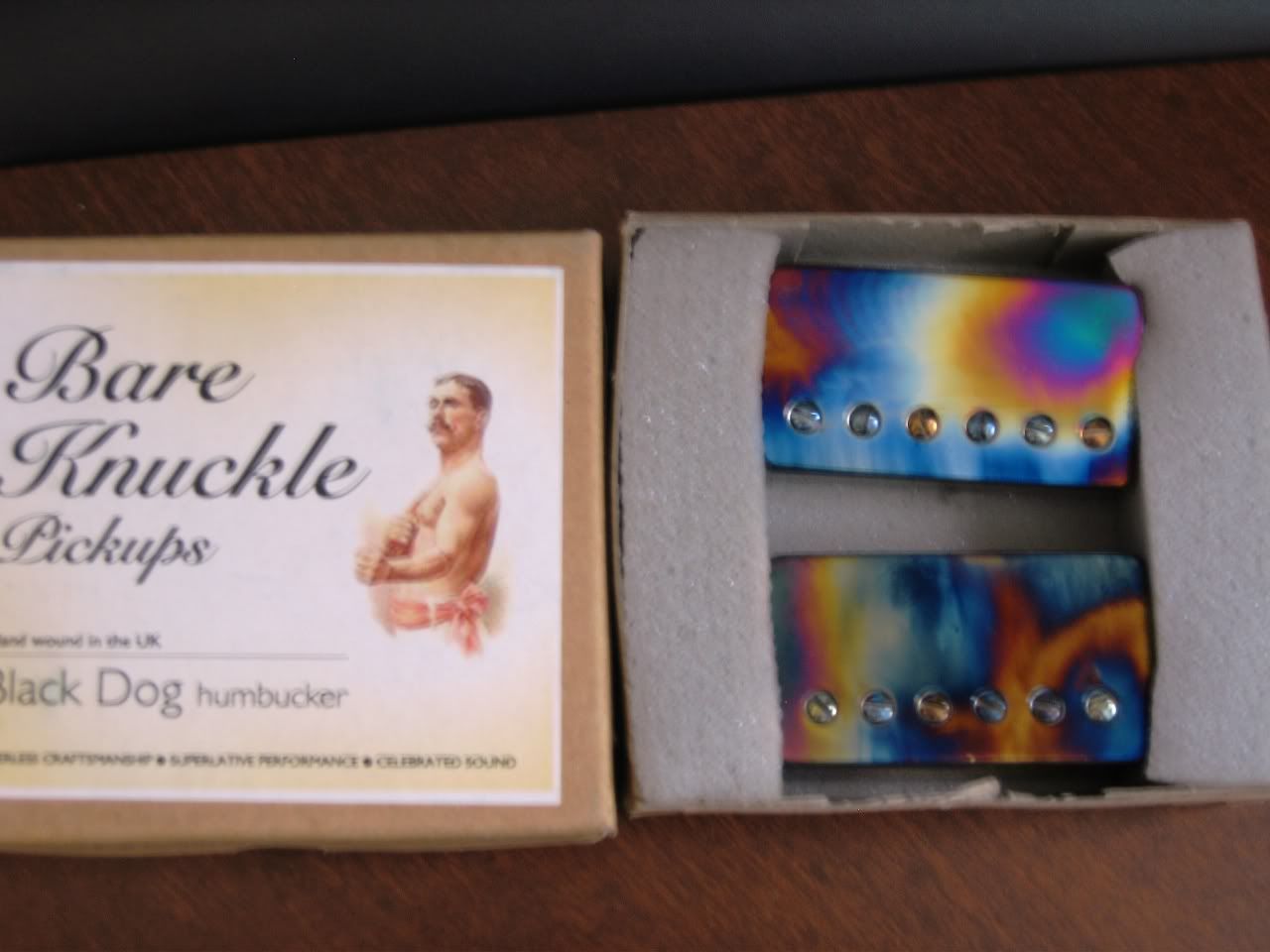

Here are some pictures of my setup... I hope to put them in this weekend.   I really think these pickups will look BAD ASS in this guitar!!!!

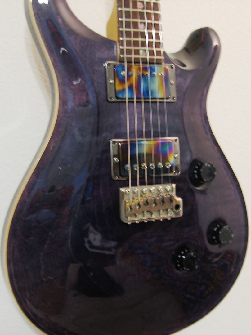

Okay.... Here they are installed!!!!
And here are my thoughts:
First thing I noticed was the drop in output...  There was a BIG difference between the 9k BK Bridge - to the PRS HFS pickup... Not as noticible difference to on the neck pickup.   But I am okay with that, a little extra volume and all is fine.  I actually like it better this way... AND LET ME TELL YOU, This guitar now pours out TONS of creamy tone!!!   Very detailed cords, you can hear every note, very round and full sounding.   The PRS pickups are good pickups, but the BareKnuckles are much more organic.
Money Well Spent... and I really like the look of the burnt chrome pickups in this guitar!!!
I am a happy man!

Well done (nice look)!My luthier had all kind of troubles to wire my BKP Mules in my PRS Cu22..!And you found a lot of useful informations about PRS wiring too!The drop in output is normal from PRS pu's to BD's.Esp.the HFS.Would you describe the BlackDogs as "bright"?

I thought that might've been the purple PRS CE 24 I had a while back, but the grains different I think.
Looks great with those pickup in, are those metal surrounds? I wouldn't mind trying those on my PRS CU 24 in Emerald Green... I have Creame and Black surrounds but these look extra special.
