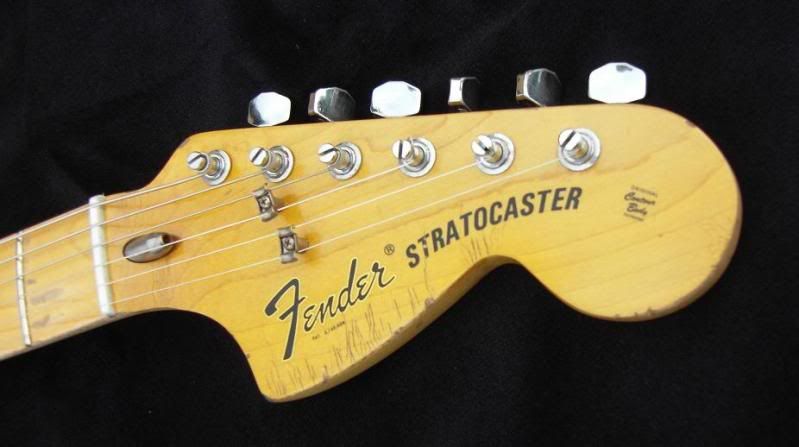

Re: VSD - Vintage Strat Day! (now the truth comes out)
« Reply #20 on: September 20, 2009, 10:08:40 PM »
more detailed one of the headstock
i have to say it was a pretty mediocre neck before - thick poly varnish, worn vintage frets, 7.5" radius.. though I liked the back profile
now its a real players tool - 9.5", gibson frets, nicely worn edges, and Wez tells me he re-worked the back as well
« Last Edit: September 20, 2009, 10:11:00 PM by gwEm »
« Reply #21 on: September 20, 2009, 10:53:42 PM »
Haha, you conniving gits!  :lol:
Nice relic job on the neck - did you even yellow the face of the headstock to give it that nitro-over-poly look?

« Reply #23 on: September 20, 2009, 11:03:27 PM »
the whole thing is nitro, but with the face of the headstock as a darker tint.

as gwem says the neck is completely nitro.  but we did the back and fretboard in a light tint to look a similar shade to poly.  the headstock was done with darker nitro to give that 70's dark headstock look.  its unauthentic to go completely nitro but feels a better guitar for it
