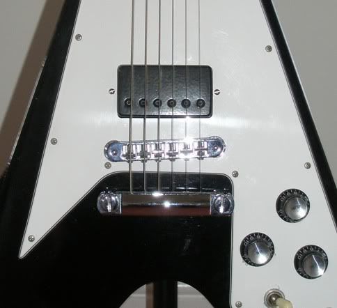

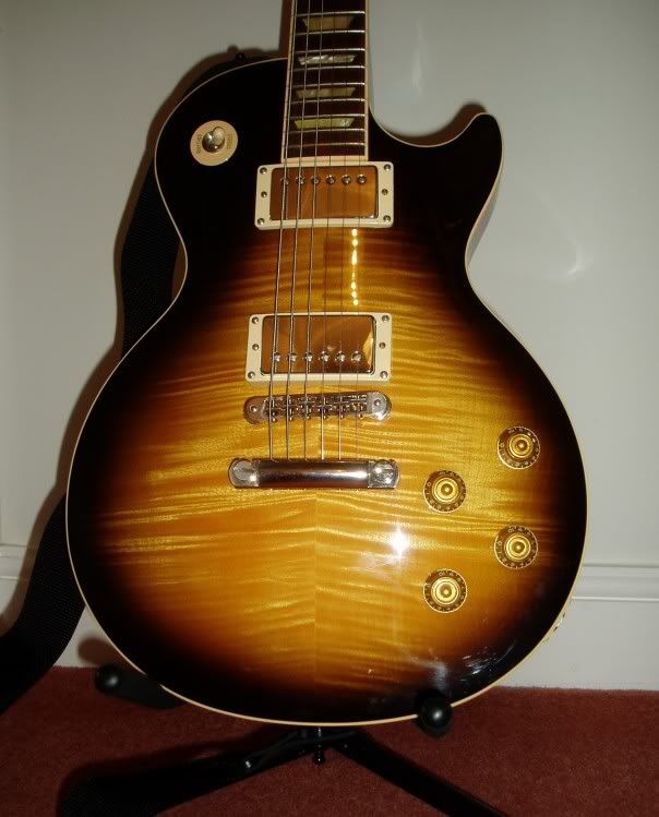

« Reply #5 on: November 21, 2009, 12:48:01 PM »
Here is how a 53mm Miracle Man lines up in my Gibson.  FWIW, This is one of my Les Pauls with a 50mm spaced bridge.
Short answer - they will probably both line up, though there are variances in the spacing of the slots on individual tunomatic bridges.  Measure the distance over the poles on your & decide which will fit.
IIRC, the long leg fits all my Gibsons & where the pickup sits very proud of the pickguard (or mouting ring if there is one) is probably the best choice.
