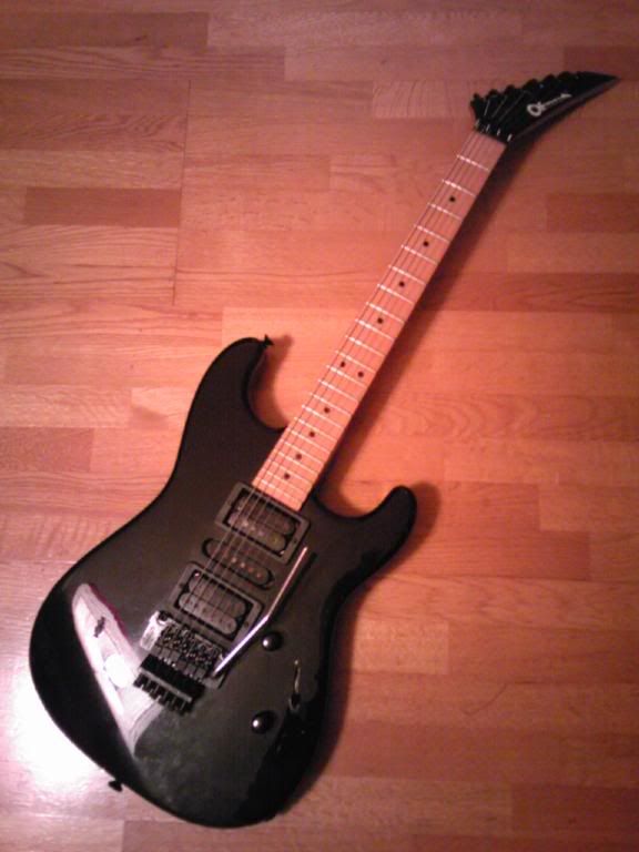

Thanks Jonathan, yes it is bolt on (AFAIK a version of the Model series rather imaginatively called the "HSH")
It's good to know there's love for these guitars on this forum :)
Here's a pic I took when I bought it. It's since had a good clean, a set of Painkillers and a Trilogy Suite added, and it's also suffered from a broken headstock and one of the bridge studs fell out! Poor old girl needs some looking after.
