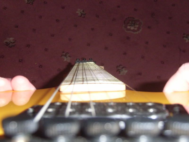

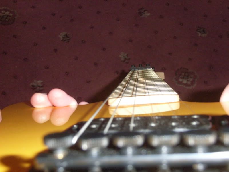

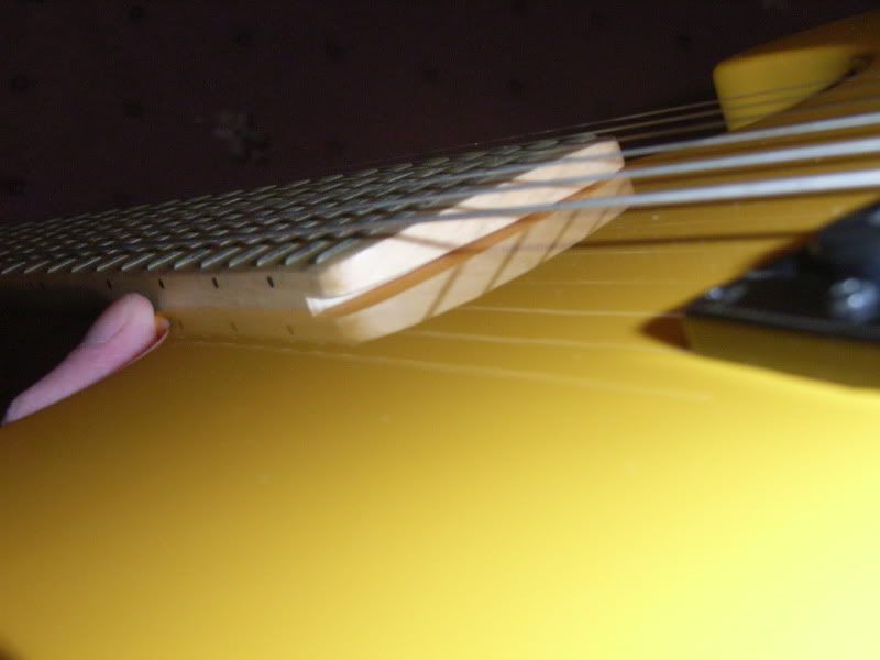

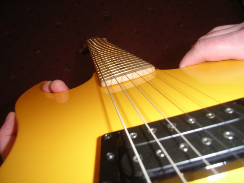

My new BC Rich Gunslinger came today, and it seems to be very nice, but I was checking it over (bought it online), and it looks to me like the neck is set into the pocket at a bit of an angle? Never seen this on a guitar before, but I wanted to check here first in case it's meant to be like that. Any ideas? I've got some pics to show what I mean:
Also, the trem is also set at an angle to accomodate the neck- is this a problem? Normally I'd set the treble side of the trem a little lower than the bass side, just so I get a slightly lower action on the higher strings, but this is a really obvious angle- it won't do any harm to the trem, will it?

OK, I have the exact same guitar and I am sat next to mine as I type so...
I think you have a shim in the bass side of the neck pocket.
I have approx 1mm clearance gap of the fretboard over hang above the body consistent from bass to treble.
Any more questions just ask.

I thought there might be a shim in there... not entirely sure why, though. When I look at the neck joint, from the back, there is like a slight gap in the neck pocket, so it might just be a shim.
I'll wait and see what feline or wez say, if they see this- just don't want to get into a situation where the seller tries to blame me, in the off-chance that there is something wrong with it and it's not just a shim.

doesnt look like anything major - but i wouldn't be happy about it arriving like that.  Is it new or second hand?
first thing i would be doing is taking the neck off and seeing what was in the pocket.  if it is a bass side shim, get it out and replace with a full width one
Re: BC Rich Gunslinger Retro question
« Reply #7 on: March 04, 2011, 11:11:05 PM »
It's not altogether a problem
if there is a shim in there that is only on one side I would remove it - or replace it with one that goes the full width
It could be that the neck pocket is deeper on the treble side in which case it sits a bit low (not optimal but not a terminal problem)

wez and feline: thanks, I was hoping you guys would see this. To answer your questions/points: it was supposed to be new. I bought it off an ebay business/guitar seller, and it was described as new. So yeah, as you say, I'm not really happy about it arriving like that. I also don't really don't want to do anything major to it in case it gives the seller a chance to claim that I was the one who damaged it.
I've shot off a couple of emails to bc rich and rosetti (their distributor here), just to see what they say- though I suspect they won't answer until Monday.
Someone pointed out on another forum that the bass side shim (that's what I now suspect it is, as you've both suggested- the neck pocket isn't a 100% tight fit at the bass side, so there might well be a shim under there) might have been done to stop buzzing on the lower strings, if the fretwork were dodgy- might that be it? If so, isn't that a bit of a half-assed fix?
I appreciate that it's not the end of the world (though as I said, I'm a bit concerned that (a) it's been done to try to disguise some other fault and (b) that the cover-up itself appears to be a bit half-assed), but I guess, would you be happy with it had you bought it new, Jonathan? (I'm not being sarcastic or anything like that, it's a serious question, I want to know what you think :) )
I guess the only other question is, what's the worst that could be wrong with it?
As I said, it's supposedly a new guitar- I don't want to have been palmed off with a b-stock one or something like that.

I would loosen each opposite & opposing screw on the gunslinger angled neck joint by a couple of turns till I could lift the neck up out of the pocket by 5mm and look inside with a torch or good light. Then re tighten in the same manner.
You would know more and not disturb anything.
