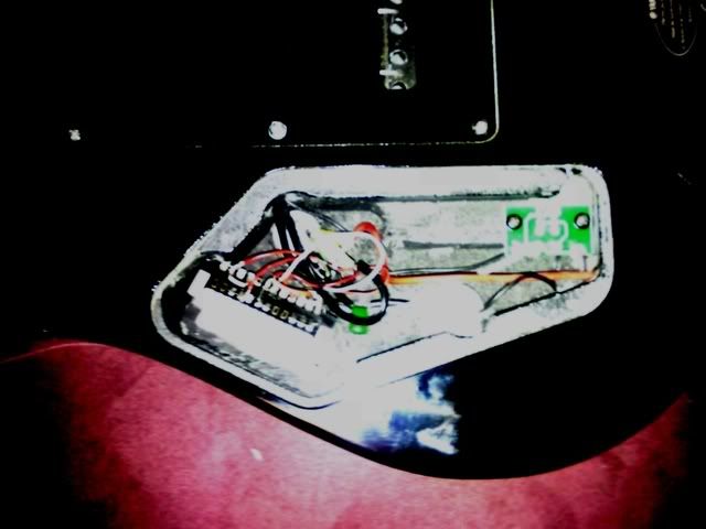

Pick of the cavity
Apologies for the lighting...
Tone is 500k i think??

lost_horizon, I can't make out a thing in the photo, to be honest.  Sorry.  :?
