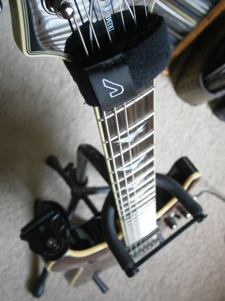

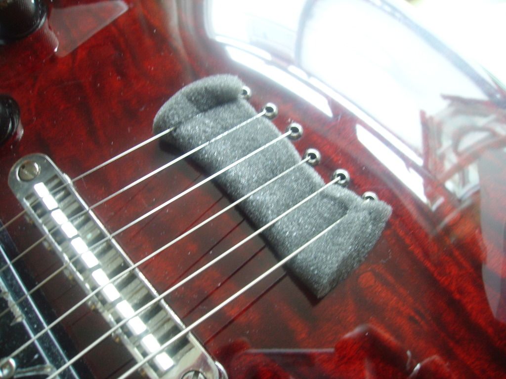

This is what i did to my guitar
It was placing the foam where the strings met the body that sorted out the ringing issue i had-i added the Gruvgear fretwrap to clean up playing and notes.
