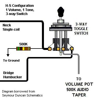

Also I got to figure out if it's better a 500k or 250k for volume and tone.
Here's a tip I got from HTH on this forum:
If you're using a single pot shared between a humbucker (or P-90) and a single-coil you can use a 500k volume pot and add a 500k resistor from the "hot" end of the single coil to ground.  That way the single-coil effectively "sees" a 250k pot when it's selected (I guess you'd still have to decide on 500k or 250K for the tone).

So I've sent a mail to Tim and he told me that many customers have an MQ in the neck and a BG in the bridge of their tele and are very happy with this combination. Tim also thinks that the yardbird bridge will easily partner with an MQ neck. He said that the MQ neck is underwound compared to the bridge and I won't have any problem of jump in volume switching from bridge only to bridge+neck to only neck! For the pots problem Tim adviced to use a 500k volume and tone.
