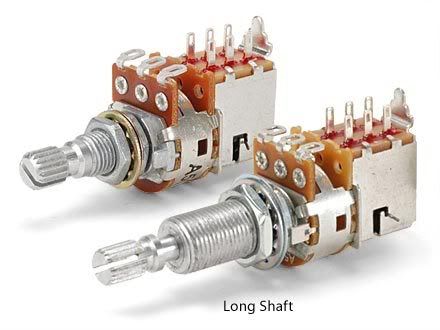

yeah, the switch i drew could either be a DPDT mini switch or a push/ pull switch attached to the volume
there are different types of switches for this but since you mentioned  the push/pull pot i drew the one you most likely will use.  They look like this:
i drew them seperately because its easier.
