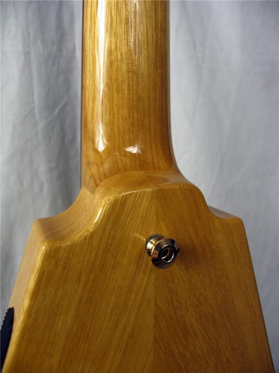

It's funny, you don't hear horror stories about Flying V neck joints but they don't have much more wood in that area than SGs do.  I'd like to see an SG with a sculpted '58 V style joint:
That looks like a chunky join! is it not possible to have an SG like that then? or is that what ESP have done with their more costly vipers?

Quote from: WillThat looks like a chunky join! is it not possible to have an SG like that then?
I don't see why not, except that the SG body is a bit thinner than a V, so the body wood under the neck tenon would be very thin.  The later '67 style V has a very thin body, but the neck joint's much longer, the neck joins the body around the 18th fret compared with the 21st on a '58.
That is exactly the way we are doing the neck joint on the 58 style V that Will has pictured above
Notice also the very tight fitting long tenon (albeit interrupted for some of iit's depth by the neck pickup)
