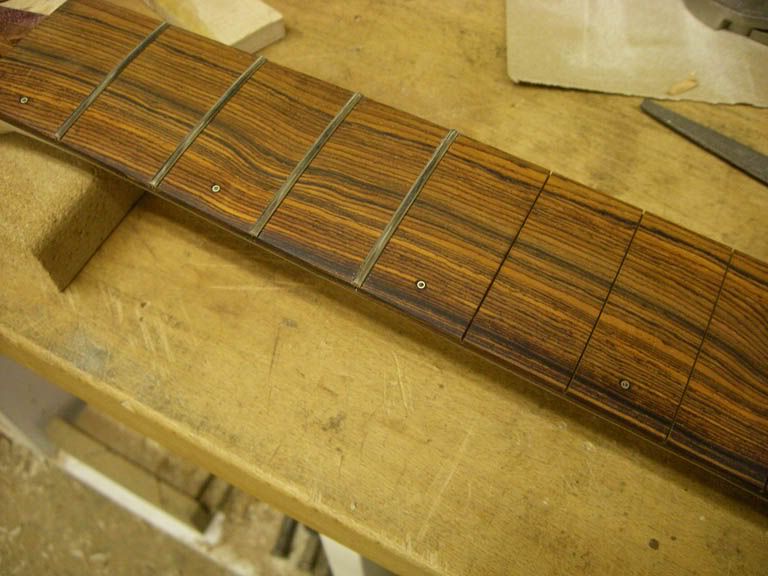

Been busy with a few other builds, so this one has been a bit slow, the inlays have been installed, and fretting started. Need to route for the pickup (which hasn't been ordered yet, no funds available :(), and then start the final sanding for the finish :)

gotta love a bit of toob... looks really good against that wood... a very nice touch that rises it aove what people can purchase easily... i like a lot and may steal ;)

Hah, it's actually much cheaper than normal inlay dots too! a piece that was over 1m long (from B&Q, shhh), was only a couple of quid. You can't really see it from that picture (i'm gonna try and get a closer shot at some point), but the inside of each tube has a little piece of abalone in it, but it doesn't really show much... especially as the tube is only 2mm diameter outside!

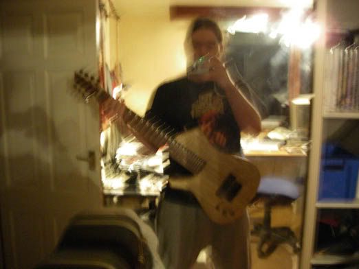

Ta-dah!
Really comfortable to hold and play:
3rd fret chord; the neck isn't too wide to be unplayable, actually feels quite comfy.
