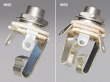

The first time I soldered the hot lead wire to the ground, so there's a constant buzz when there's no signal, and when I play a note the buzz goes away until the sound fades.
I found a fault in the ground connection on the back of the volume pot, and once I fixed that, the ground buzz went away.
Then I had to switch the wires on the output, the volume was tiny before the switch, afterwards it was really loud.
I can't think of what else to fix, if you look at the pic I posted, the inside of my output jack is very difference from all the pics I've seen, there's just 3 straight legs, 2 short and 1 long.
I might switch around the wires on that some more and see if there's a difference, but it feels OK right now, the sound I mean.
then you probably have it right now and that can be ruled out.  Mono jacks have only 2 connections so you either have a signal or you have a loud buzzing like you described..  sounds like you have a stereo jack so an extra connection that should be unused unless you are using it to switch on any gizmo's like fret LED's
here is a picture of a normal jack and a stereo jack to confirm if this is what you have, i cant see a picture you have posted:
obviously it could all be down to your amp and pedals but i think it would be a shame to go out and buy a nice new amp to find its still the guitar at fault
