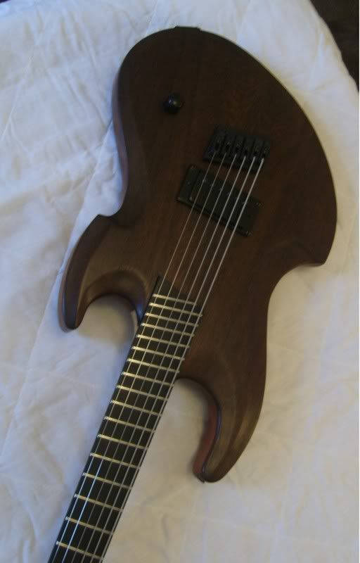

here she is:
its a maple/bubinga/wenge neck through with bubinga wings and wenge top and ebony fretboard.    natural oil finish which feels great
Scale lengths are 28" on the bass side and 26.5" on the bass.  Obviously the bridge is inspired by the blackmachine ones (credit where its due ;) ) currently tuned to A, E, A, D, F#, B
Tuners are sperzels, i had a moment with those a few months ago when i realised they would not fit the low baritone strings.. a quick phone call direct to sperzel and 2 weeks later i received a custom set of sperzels with larger post holes.. damn fine people to deal with!!
Pickup is a Blackdog.  we were talking about warpigs and painkillers but after a chat with Tim it had to be blackdog.  he said it was his favorite for baritones

cheers 38th
i know this one might be a crowd splitter but i am really proud of how its turned out, especially the carved bevels and the way it feels... its good when you are given the freedom to try these things
one things for certain... its definately not a telecaster!!! lol
its being picked up by Roo tomorrow!!

Those contours/bevels are great, I love how it's a metal machine from the front and a completely different beast from the back.

well i was told to make it mean but not like something a 16 year old would play.  roo and i spent a few weeks sending drawing back and forth getting the design where we wanted so its as mcuh his design as mine

no, but it is the same technique taken much further.. the SG ones are subtle enough to be nearly unnoticeable... but definately help the look

It looks great Wez, I'm sure it sounds awesome too.  The guitar does look is little schitzophrenic, with the dark front and light back.  I bet the Wenge top was a bitch to carve!!
