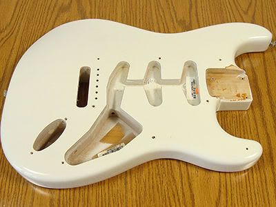

« Reply #6 on: May 24, 2009, 10:22:04 PM »
Doesn't Eric Johnson does this and have it done on his sig model?
Doesn't look like it:
