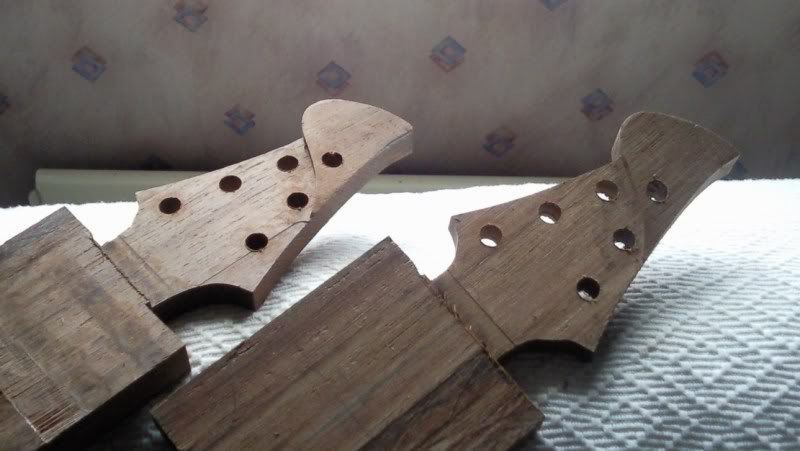

starting routing the shape of the headstocks before scarfing today, and the first one has split. a lot. damn it

indeed. its cos its quarter sawn the router bit has just pulled the end grain to pieces. iv ordered some blades for my scroll saw which iv never used since it was given to me a couple of years ago. iv been meaning to get some for ages and this is the perfect excuse

scroll saw blades came today after ordering them last night from axminster and got the two headstocks cut out. for my first go on a scroll saw i didnt do too bad.
they're still a bit rough. will do inlays tomorrow then they'll be ready for scarfing onto the necks

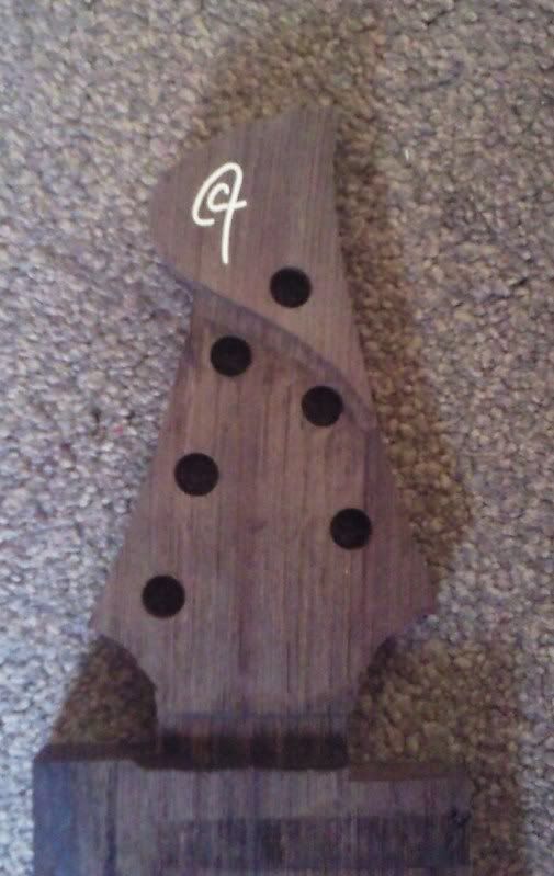

one of the stirling silver logos
[url="http://www.afguitars.co.uk"]http://www.afguitars.co.uk[/url]
Welterweight
Posts: 3,978
Location: Brazil
Logged
Re: a matching pair
#22
August 28, 2009, 10:58:48 PM
Very nice! It's done exactly like a pearl inlay? very thin letter :o
hooglebug
Bantamweight
Posts: 123
Location: Wakefield, yorkshire
Logged
Re: a matching pair
#23
August 28, 2009, 11:10:55 PM
its silver wire. route the inlay cavity like normal but then cut and bend the wire to shape to fit into it

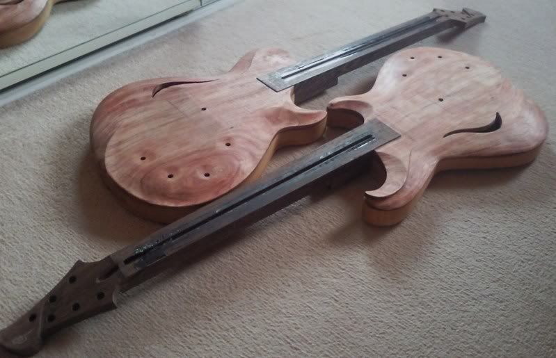

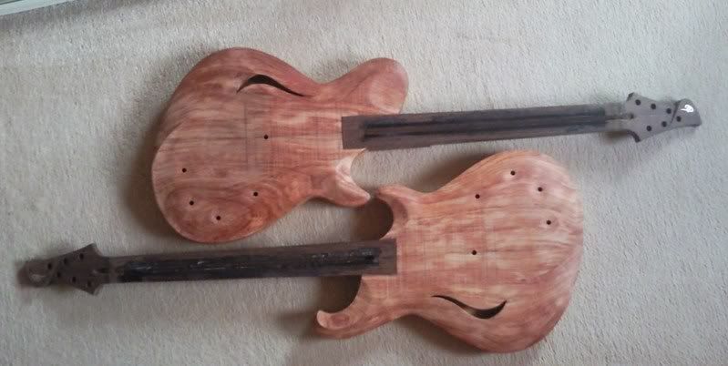

September 16, 2009, 03:42:01 PM
finally managed to get more done over the last few days. scarfed the headstocks and did the neck profile. glued in the cf rods and routed the neck pocket. both are nice tight fits and light as a feather. obviously the tops will add some weight but i think they're gonna come in at quite a nice weight overall
gingataff
Welterweight
Posts: 1,872
NBVHIIMMPKAHITTSSH
Location: Tokyo.
Logged
Re: a matching pair
#26
September 16, 2009, 03:53:59 PM
I can't decide which I like better, the Sakura or the Desiree, they both give me the horn.
