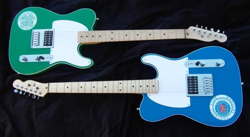

Both the Celtic and Rangers Esquires are looking great Wez!

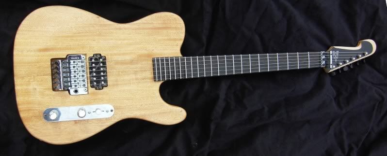

just about done with this one:

Looking good - I was dubious about the headstock originally, but it's grown on me :D
Still quite can't get over the look of a bridge like that on a tele (or, any guitar) personally, though!

dear god that Esquire looks $%&#ing awesome....

Good job you like it!  :wink:
What's the battery compartment for?

It's to access the jack, I didn't want the stupid traditional Tele jack cup.

:lol:  I didn't know there was a Rangers one on the way too!  Don't keep them too close together!
Especially after todays result :P
Great looking guitars Wez!

The Celtic/Rangers Esquires look great!  Are they identical (apart from the livery)?
Re: busy busy!!!
« Reply #71 on: March 07, 2010, 06:42:53 PM »
the celtic is old mahogany, the rangers is sapelle. and the rangers has a chunkier neck  Other than that they are identical construction
wiring is Blackdog pickups with a c--ked wah push/pull and series/split/parallel on the 3-way switch
there is a slight tonal difference, the celtic has a little more meat to it but the rangers has a little better single coil tone... but they can be made identical with a little eq tweak

They look great, Wez.

The Rangers one reminds me so much of the LPB Esquire I sold to Dave  :(
