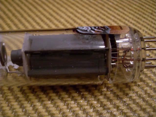

Hi guy's, I'm new to this forum and noticed the thread asking which EL84 to recommend. After reading through some great discussions I was still not sure which way to go.
My problem is, I have a Blues Junior, which after one year of very moderate use has blown one of the Groove Tube EL84's. It looks like it's over heated and after reading other forums it appears the reason may be down to the Bias and the fact the BJ run's a bit hot and therefore the picture below is the result.
Before this happened I was very happy with the overall tone, my BJ is the Tweed version with the Celestion Vintage 30.
Can anyone recommend a valve which will not change the tone to much but be able to cope with the extra heat being generated.
Elliot
Until I had my BJr modded to 6v6 - I use to get through a pair of EL84s after 1 year - the cure is to drop the overly hot bias, which cooks the EL84s - but even then EL84s don't last that long - 2 years at the best.  Many people talk of the speaker breaking in and more bass coming - this is generally the EL84s going.
JJs, EH, etc - all much of a muchness in terms of lasting out the term but expect 1 year to be your lot with the hot bias.  If you don't want to change the sound buy a matched quad of Groove Tubes - they are the ones the amp comes with.
Alternatively, get someone the BillM kit or someone like JPF or MJW to put in a bias mod.
I love EH's EL84's. But I heard they are not reliable as JJ's.
Elliot
Given the macho biasing of almost all modern EL84 amps (the Blues Junior is not the only culprit) no brand of tube is going to last very long!
