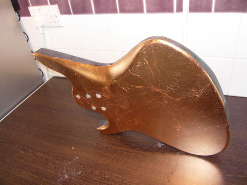

« Reply #29 on: April 30, 2010, 07:30:12 PM »
well - lets see about that ;)
trial metal leaf finish number 2 - going for a different look here, the idea for this one is a more traditional gilded finish, so i went with an acrylic size (the glue/varnish that sticks it down) and loose leaf copper (rather than the transfer stuff i have used so far).
once complete the plan is to age the copper to start to develop some green - rather than wait 10-15 years i am going to accelerate the process before lacquering.   i have looked around for chemicals to age it and two easy ones keep popping up.   apparently urine does a good job, but a salt & vinegar mix also works well - so i think i had better use that.
anyway - just done the rear of the bass and i am rather happy so far.  still needs a little burnishing but it has worked well
