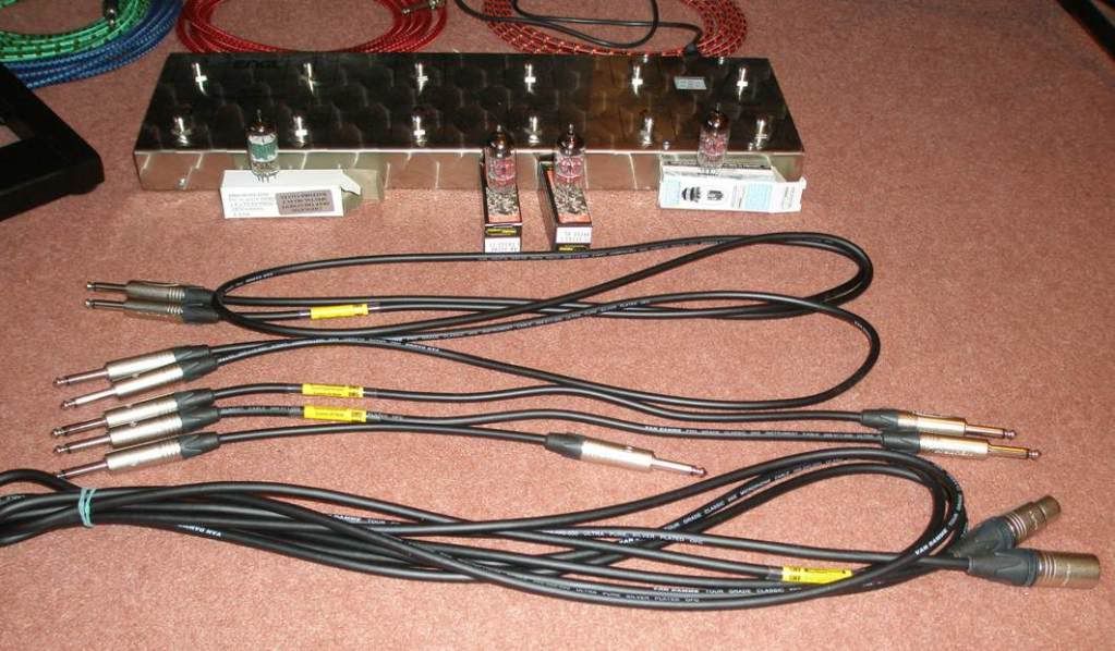

Got some Cleartone cables in the correct lengths from Award Session, plus an XLR cable to take advantage of the balanced outputs of the SE (which allegedly have cabinet emulation built in, will be interesting to see how it sounds direct)

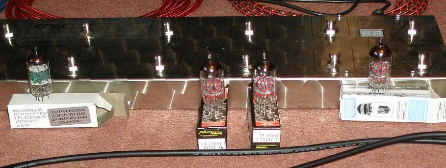

& some valves from Watford Valves (as an aside, I put this order in Thursday afternoon & the postman knocked on my door Saturday morning)
JAN Philips 5751 for VI, 2 JJ ECC83S DR250 for V2 & 3 & another JJ for V4.
Will post some impressions of the valve change when fitted (plus gutshots if I remember to take them :))

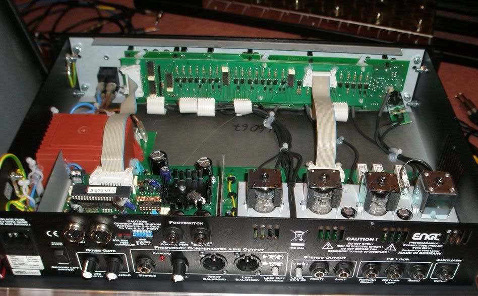

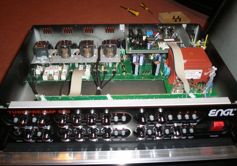

Just changed the valves, it sounded good stock, but now it's absolutely unreal :twisted: :lol: :D
Interestingly the stock valves in the Savage looked identical to JJs, but the stock valves in the SE look identical to some TADs I have.  Also, in the SE there's a fairly sturdy metal plate that the valves are mounted onto, but the Savage looked like they were mounted directly onto the PCB.
Had a problem initially, in that there was no sound from classic mode :? (but was from modern mode).  The problem is that the manual isn't entirely clear what the valves do.  But the SE head manual has a bit more info:
v1 "Input & TD circuit
v2 "2. stage & lead driver
v3 "3. stage & Classic enhancer"
v4 "FX buffer & PA driver"
So I deduced that the JJ I put in V3's second stage was dead.  Swapped back to stock & it worked.  Luckily I had a spare JJ DR250, so I put that in V3.  It sounds absolutely wonderful now.
Here are some gutshots:
I am so tempted to pull a sickie & stay home to play :lol: ;)
