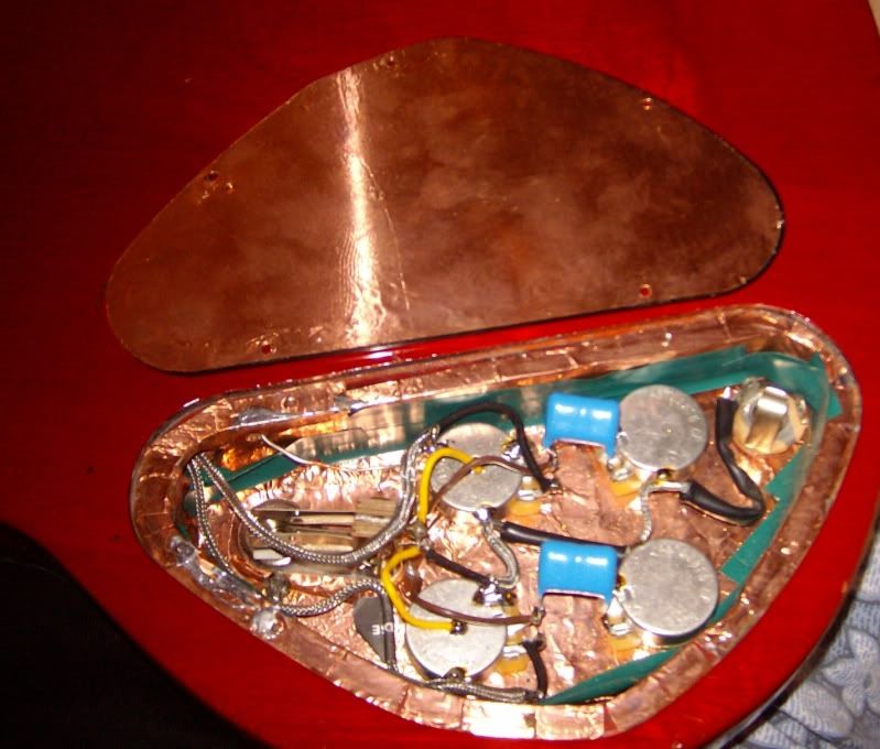

-high quality exact 500kohm vol AND tone pots (Gibson had installed 200kohm tone pots!)
-new transistors
-my own copper foil shielding

OK, pimped electronics:

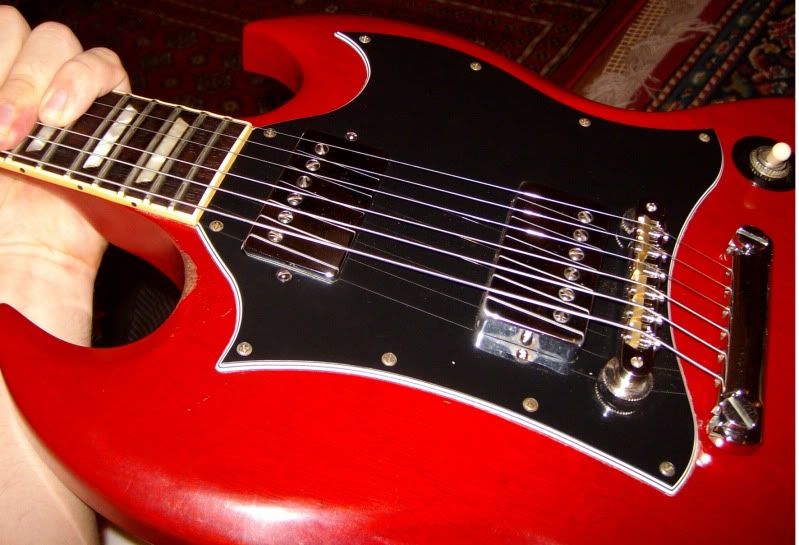

Everything else:
As you can see, my poor baby is played down to the wood in some places, also I once broke out a big chunk of wood when i stepped on the cable while playing (which was glued in again), but scars just add character, don't they?
Besides, she fits me well, my shins look like Tony Hawks' and my knee has just recently been 'glued together' again :lol:
