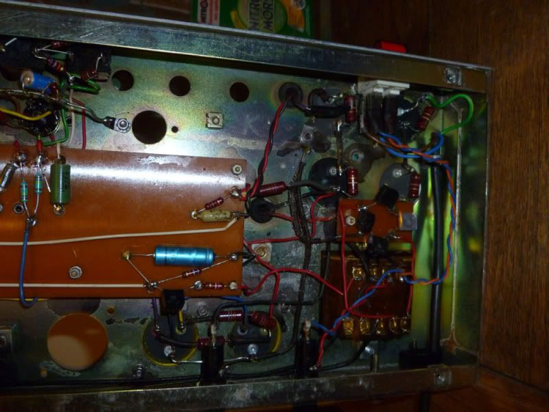

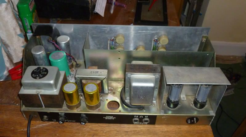

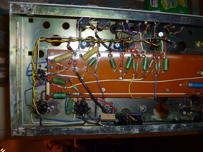

Post some gut shots and I'll tell you if the smoothing caps on the HT line are original or not.
If they ARE original, a cap job is in order.  It's worth cleaning the pots, jacks and valve bases too - Servisol lubricant spray for the pots, and non-lubricating for the jacks/valve bases.  You'll be amazed at how much snap/crackle/pop can be reduced by such simple maintenance.
It's also worth replacing the bias caps while you're at it.
here we go

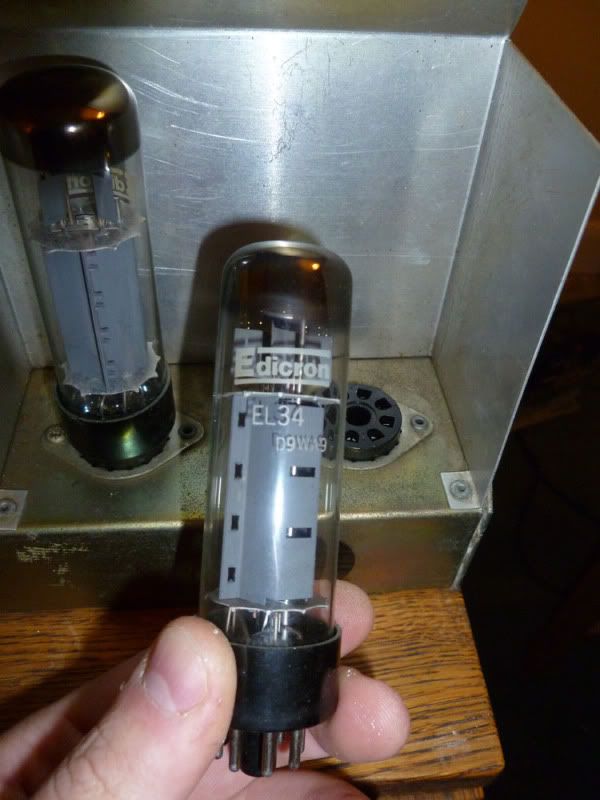

You've made out ok there Wez, those EL34s look like old Siemens ones - great midrange crunch and spit, snarly as fook  :D
The smoothing caps are the originals, but it's tough to see what kind of shape they're in.  My thoughts are that on a 40+ year old amp, it makes sense to replace all the filter caps.  Also do the bias cap while you're at it.
Looks nice and clean inside too, makes a change for Selmers which are normally woefully looked after.

Well a service and any mods may have to wait a few weeks, but i just borrowed some TAD tone Bones from a mate which  are a plug and play option to reduce this down to about 8w.
BAsically the EL34's get swapped for 84's.  but since it doesnt need to be re-biased to do the EL34's can be slotted back in at any time
Its still loud, as 8 valve watts should be - but the first 3rd of the volume sweep is now suitable for home use as opposed to just turning it on its lowest setting.
