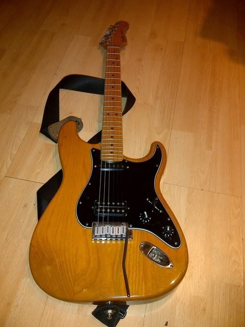

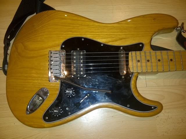

It's back! Feline has done some work.
3 ply plate added with a HS setup. Nailbomb and an Irish tour. 3 way tele switch. Volume knob in a better spot. One vol, one tone. The snaggy nut replaced with an LSR and the correct trem arm found by Jonathan. Sound like a beast. Loving the neck and middle positions.

The black scratchplate really changes the look.  I like it!
