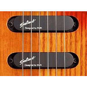

So yeah, I think I might go with Abraxas and Slow Hand combo.
Now, these two aren't part of any HSS set, which I guess feature the Hum cancelling stuff. Is that gonna prove a big issue? (again, as previously said, I know nuffin about pickups).
I have an Abraxas/Slow Hand set - can't tell you what they sound like, because I haven't tried them yet!
As you say, you can't order them as a set through the online shop, so I ordered over the phone.
I chose the option of a reverse wound/reverse polarity middle pickup so I get hum-cancelling in positions 1, 2 and 4 on the five-way switch.
Also, looking at your guitar, you would need to order the Slow Hands "EMG-shaped", normal single-coils won't fit those pickup cavities.

Forgive me if someone has already pointed this out
The EMG selcet single coils are often put in a body routing that doesn't have the little V shape on the pickups lower side
like this
whilst all the BKP single coils require that v to be cut into the body when being installed as they are like this
This could result in you needing to have some routing done to your guitar to fit these new pickups
The dimensions can be found here
https://bareknucklepickups.co.uk/main/downloads/dimensions/strats/strat_single_coil.pdf

« Reply #20 on: June 26, 2012, 06:07:21 PM »
Ofcourse, now that particular perdicament comes to light. I do hope ordering those Slow Hands "EMG-Shaped" as you put it won't add too much to the cost. Or if even possible, lest I'm screwed.
Also trying to find them dimensions on the EMGs aswell, guess I'll be needing that for the order. I'm going out on a limb and saying that the dimensions for EMG pickups are the same, no matter if I got what appears to be old Select pickups compared to new.
Also, EMG has their dimensions in inches rather than millimeter, which after a quick conversion doesn't match the Bare knuckle ones by about a mm or so. But I guess that's because of the conversion and so this is not a problem and that screw holes and whatnot is the same dimension, as is the size of the pickup itself, which means it's just the V shape that's the issue?
Probably a stupid question, but. Would appreciate some clarifications on this. I could ofcourse just go measure. But I don't trust me eyes.
Re: Could use some advice on a S/S/H setup.
« Reply #21 on: June 26, 2012, 06:26:54 PM »
I can't speak from personal experience, but I believe the extra V-shaped "lip" is the only obstacle to fitting the pickups, all the other dimensions should be close enough to "standard".
BKP definitely used to offer an "EMG-shape" option for single-coils - I don't think there was any additional cost - but it may not still be available.  Best to phone/email to confirm.
