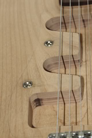

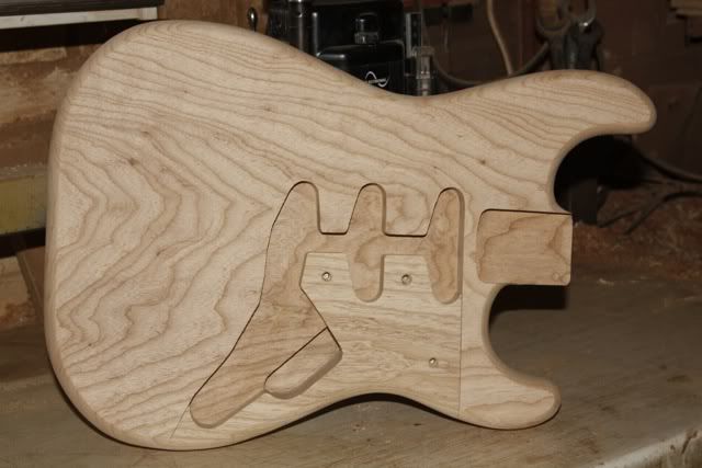

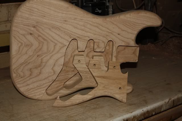

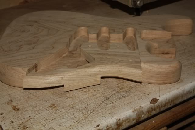

Re: The Stratocaster: The guitar of Ultimate Versatility?
« Reply #3 on: October 14, 2012, 08:59:51 PM »
i believe mr feline has something like this
other than some grain not matching on a small portion of the bottom edge i think its a great idea
obviously you can just swap pickguards - but you have to take of all the strings to do it and invariably you end up just not being bothered to do it
the old john birch version

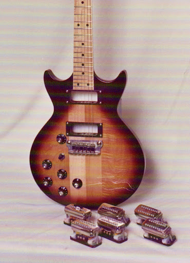

« Reply #4 on: October 14, 2012, 09:00:55 PM »
You'd still need to solder the ground connection....
loads of quick connect systems available. for the ground and jack socket wires
