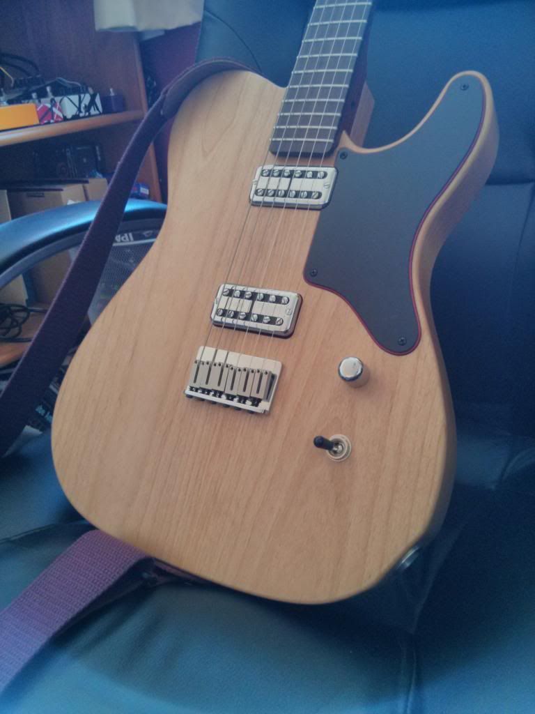

looks great! did you use any wood dye, or just the tru oil and wax?
Re: guitar build, finish advice needed
« Reply #91 on: March 13, 2013, 12:45:13 PM »
I was just gonna +1 juansolo's comment... but I think it's more along the lines of:
niiiiiiiiiiiiiiiiiiiiiiiiiiiiiiiiice :D :lol:
I'd be interested to know if wood dye was involved as well (although, from the pics, I suspect not). My memory of doing this is that the "wood dye stage" was the scariest bit (and the most likely to go horribly wrong looks-wise).
On the "wishing for a more figured top" - I think that will wear off. It did for me at least... I went through roughly the same thing (this was a big ole lump of mahogany). When I first saw the effect of the oil and wax, there was a real feeling of "wow! that's cool, pity the wood itself isn't very interesting...". And, yes, just a tiny bit more interesting would have been stunning when I first finished... but after living with it for a while, actually, the wood is a lot more interesting than I realised at the time!

No dye, just oil and wax. The oil slightly changed the colour of the raw wood to a slightly yellow colour, then that turned into a warmer colour after a few coats.
This will be a working gigging guitar so will pick up the odd knock and scr@pe, possibly best I didn't have an expensive nice piece of wood ;-)

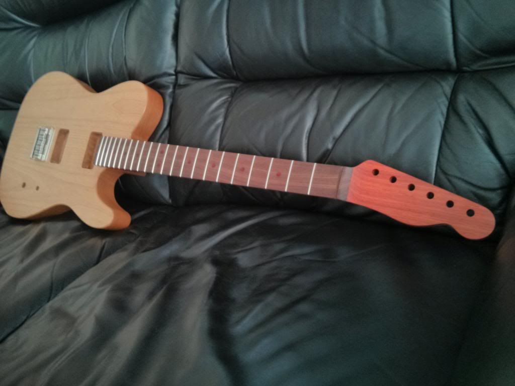

I have a quick question about my new neck, that's being delivered today  :D
When selecting options on the Warmoth site, it said I could not select a Finish due to wood choice, the padauk...
Can/should i use Tru oil on the back of the neck? And possibly lemon oil on the phone ferro fingerboard?
Thanks
Pete
« Reply #94 on: March 25, 2013, 10:56:14 AM »
Check with Wez, I think he's said before that he still prefers to use a bit of oil/wax on neck woods which don't "need" a finish.  It's not necessary to protect the wood, but it probably makes it feel better to play.
As for the pau ferro fretboard, treat it the same as a typical unfinished rosewood/ebony fretboard.

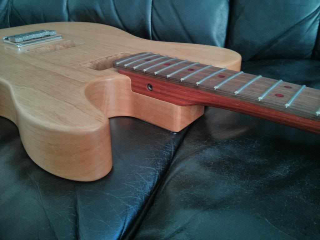

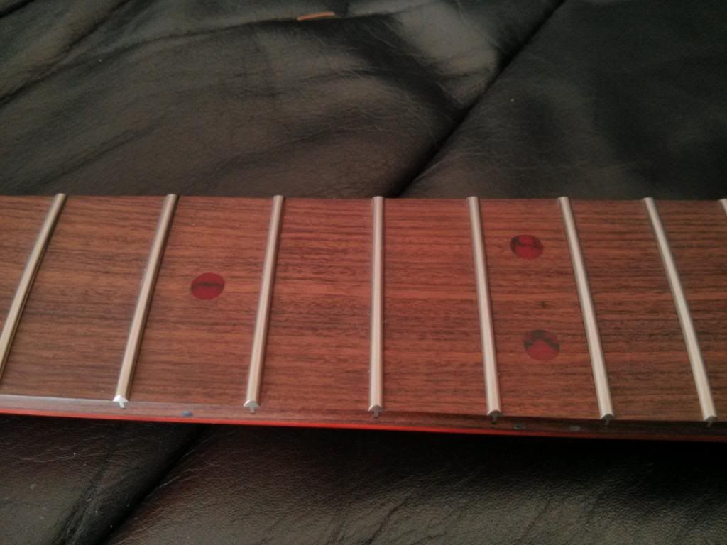

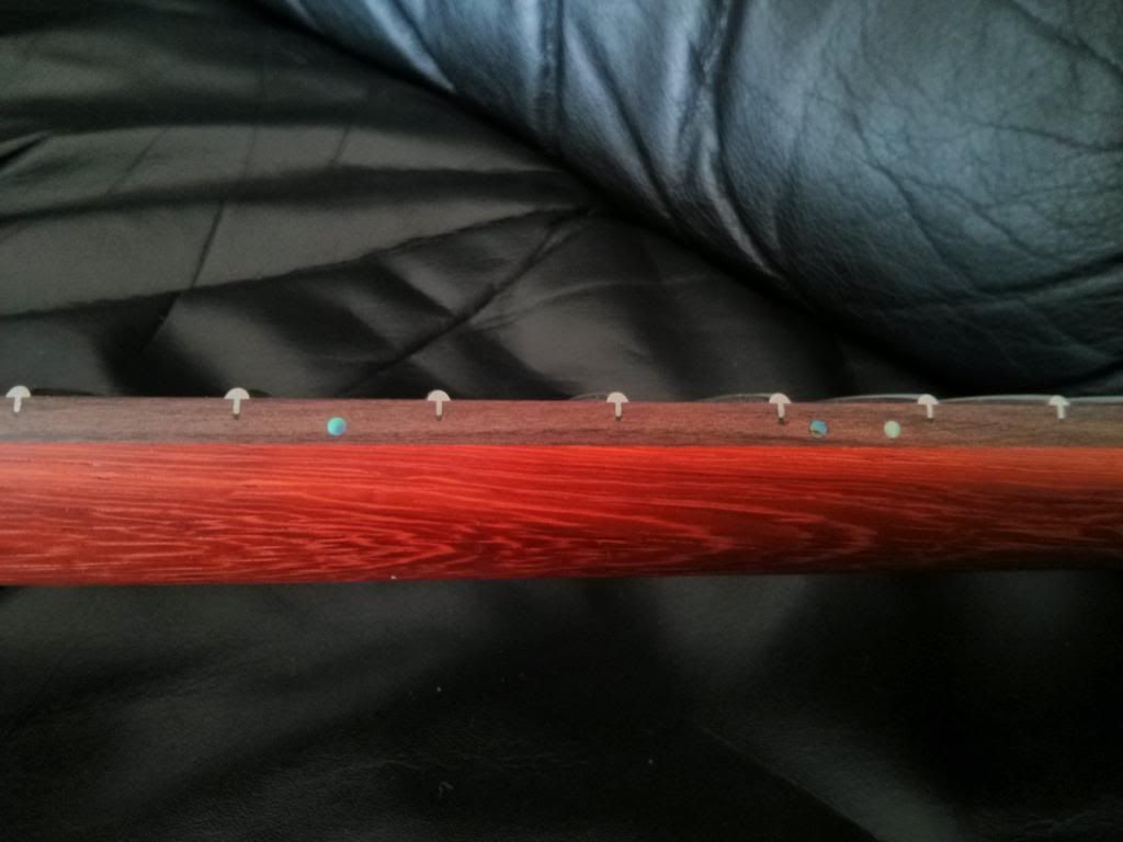

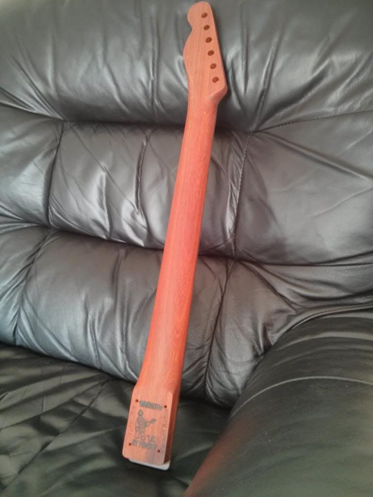

here's a few photo's of the neck
It's now exactly the same dimensions as my favourite Warmoth Tele neck, feels great, and i love the looks  :D :D
Now a can't wait to get this finished!!

I've never seen inlays like that before, very unusual!  :D
And the Fatback doesn't look too huge, not that that's any way to judge!  :lol:

The inlays are called Bloody Jasper Basin, or something like that! Quite unusual, for my unusual guitar.
I don't think the fatback is too big, it's very comfortable for me.

what philly said - it doesn't "need" it, but it will definitely feel nicer after a bit of oil or wax.   it will also make the colour a bit richer.    for this neck i would simply wipe on/wipe off danish oil and buff away.   I dont like tru-oil on wood with large pores, and paduak can have massive pores
Pete24v
  • Posts: 295
« Reply #99 on: March 25, 2013, 07:20:47 PM »
Thanks for that, I've just ordered a small tin of Danish oil. I can see quite a few big open pores, very much like my old N4 neck.

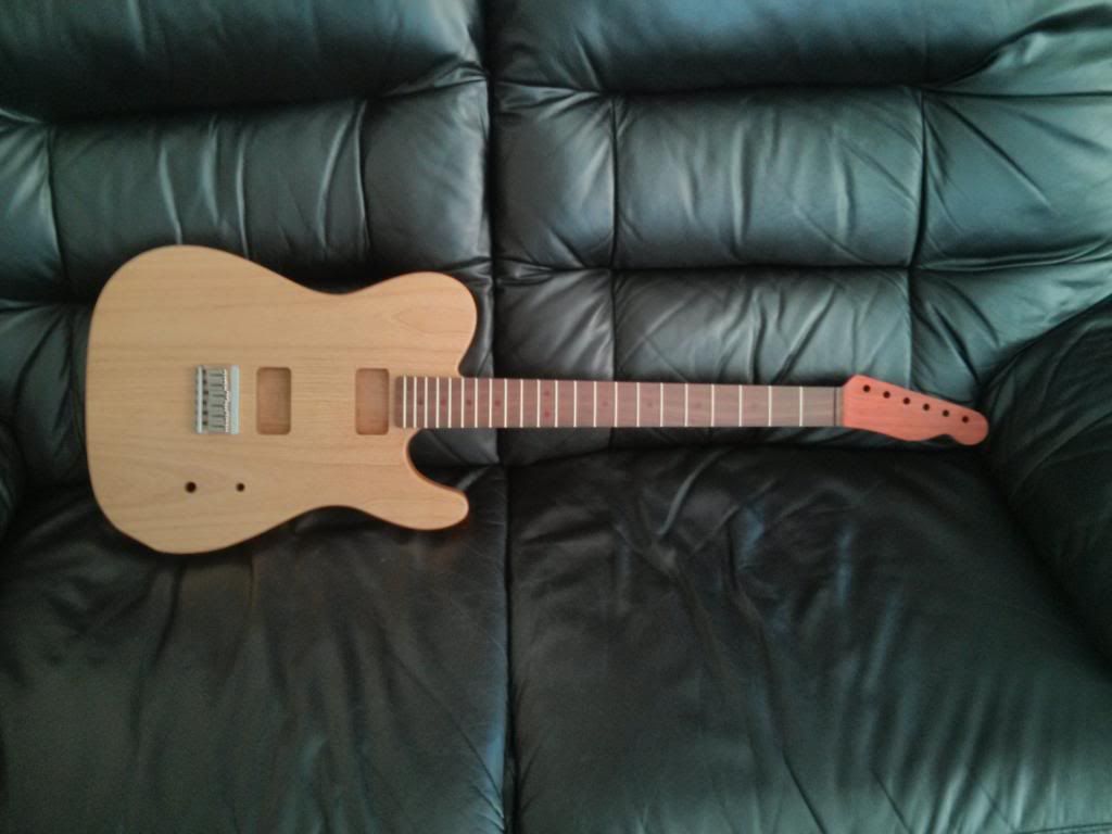

put a few things together..

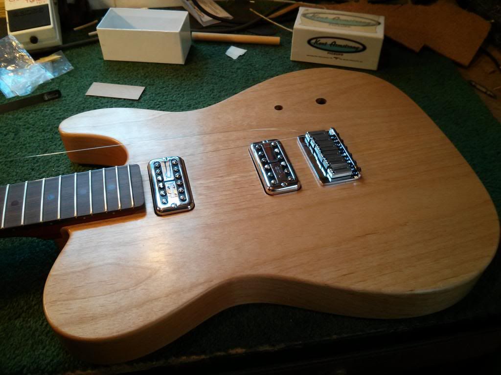

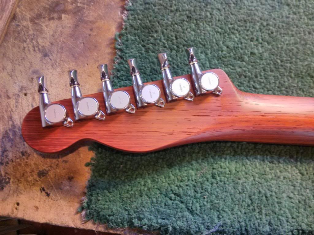

Done 1 coat of Danish oil, really does make it look richer! Should I do a few coats?
« Reply #102 on: March 31, 2013, 03:27:22 PM »
can't really go wrong with the danish oil, just keep rubbing it in and buffing straight off - 3 or 4 times should do fine
also fine to go on the fretboard too but give it at least a day before the last coat of danish and the strings going on

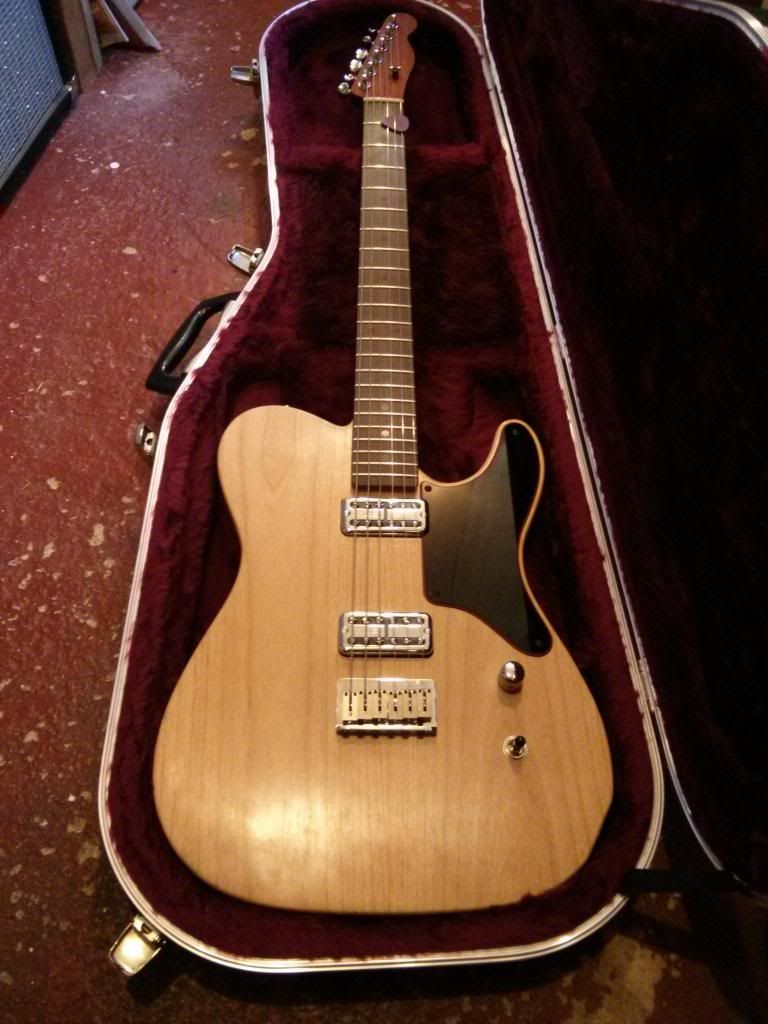

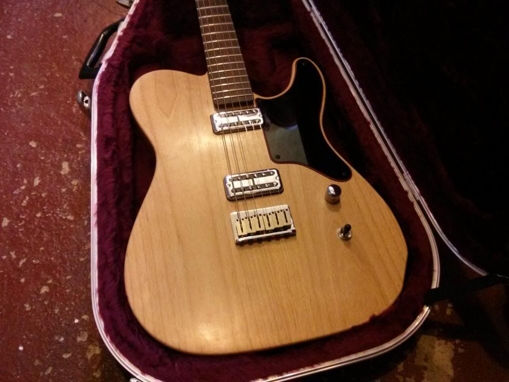

Finally finished the build today, well, a local luthier did!
Really happy with the end result.
Andrew W
  • Posts: 1350
« Reply #104 on: April 03, 2013, 06:08:57 PM »
That is a very handsome beastie indeed. Love it. How's it sound?
