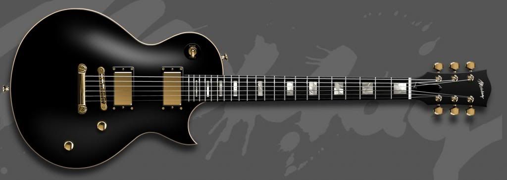

Here's a shameless plug of the guitars. They're all mahogany with maple cap but will have different neck woods. The purple one is walnut, the green flamed maple, and the black will be mahogany. Not sure how much the neck contribues to tone for someone almost always on the bridge pickup. The black one is being built and about a month away. Now to decide on gold or aged gold covers  :mrgreen:. Brushed gold would be sweet but doesn't look like they offer it.

Gold ages really quickly anyway.  Just forget to wipe it after you play it and it will be faded and pitted looking in six months.
I'm swapping out some 'aged' gold hardware from my Epiphone Explorer if anyone wants some, including some aged inline Grover mini-rotomatics
