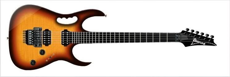

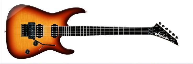

« Reply #11 on: August 02, 2006, 07:00:22 PM »
Yeah, like the virtual Jem I've been playing with.
But I can't decide if it'd be better as a Jackson...
I made an awesome faded-reverse-lime-greenburst-relic-flamed-maple telecaster last night.
