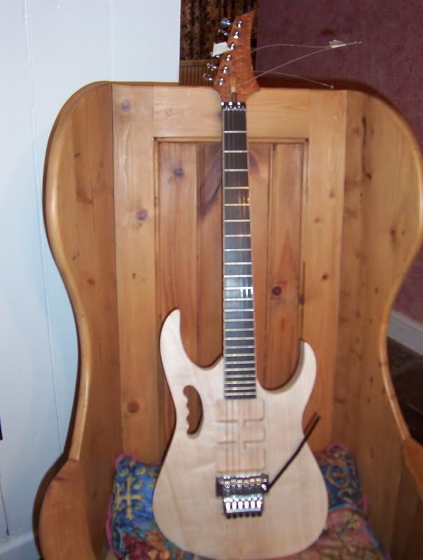

Right well the neck is sanded to 600grit and I have solved the problem about using rear bolt lock-nuts.  Also it has had one coat of Danish oil dilute with 20% white spirt to help it penatrate.
http://i4.photobucket.com/albums/y125/mcmeat51/misc_0393.jpg     back of neck
http://i4.photobucket.com/albums/y125/mcmeat51/misc_0392.jpg     fretboard
http://i4.photobucket.com/albums/y125/mcmeat51/misc_0391.jpg     headstock
Im afraid the piccy's are rubbish as
a) our camara is cr@p
b) Half the lights have just blown in the workshop
c) Im not very good a taking photo's :blush
Can't wait till I finish this!!!!!
Thanks
matt

ooooh schmexy, are you putting any inlays into the fretboard??
Miracle Man Matt
No I like the look of plain ebony fretboards with no markers. nice and clean looking I think.

Well Ive done a bit more to my hallowed guitar.  Thanks to Feline guitars for the fret wire.
Unfortunatley my fretwork is not perfect as I had already oiled the neck before i started putting the frets in...bad idea.  So I will probably make a neck again that will be accurate to a gnats wots'it.
Also as you can see the body is nearly finished, but Im gonna make myself a scratchplate similar to the headstock as standard ones cost an arm and a leg.

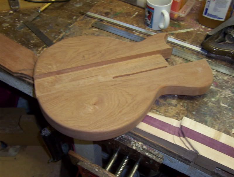

Then Im building a Les Paul Junior for someone.

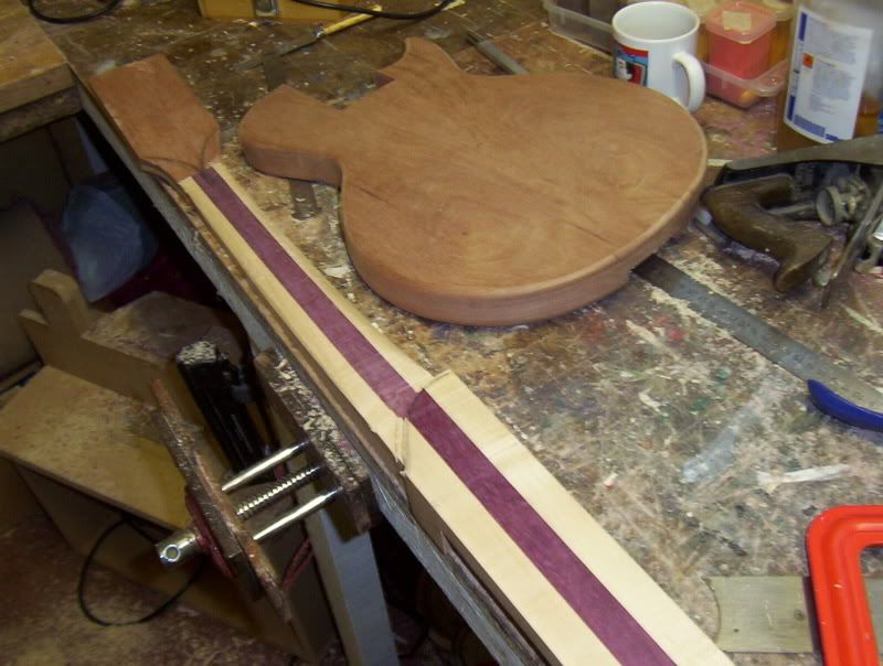

Chambered Mahogany body, similar neck to the one above except purpleheart stripe,
Semi neck-thru (not visable from the front)
SD Jazz neck and BKP RY for the bridge.
Im sorry to be persistant...but I'm on a mission to build the most badass guitar of all time.
that purple heart looks tasty - is it a fairly soft wood like mahogany?
:twisted:
Davey
FAIK purpleheart is hard as steel :P
[url="http://soundcloud.com/DeclineOfSociety"]http://soundcloud.com/DeclineOfSociety[/url]
[url="http://soundcloud.com/IgorVonE"]http://soundcloud.com/IgorVonE[/url]
Miracle Man Matt
QuoteFAIK purpleheart is hard as steel
haha yea couldn't be more right... someone described it as 'maple on steroids' and thats probably the best description of it, it also splinters easily as well, and I kept taking chunks out when carving it.... it ok now tho.
