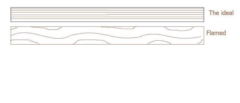

I would just like to point out that flamed wood in necks on factory made guitars is not always a desirable thing.  In this case i would have been more cautious because:
. . . mahogany is a softer wood than most other neck woods used in guitars (unless you count some of the old cheapo archtops with poplar necks). . .
. . . and flamed wood is structurally weaker than straight grained wood.
. . . SG's have weaker neck/body joins than most guitars because most of the neck is free of the body and the tenon is relatively short
. . . Gibson generally make there necks out of one peice of wood
. . . i am fairly sure gibson will not have added any extra reinforcement to help stabilise the figured neck
Figured (flamed/quilted/birdseye/spalted) woods are great for adding visual interest to a guitar but there are certain areas where a little bit more thought is needed.
I am not saying flamed wood cannot be used in necks - i use it myself all the time.  But if using figured woods i generally make a laminated neck with 3 or more peices and i always include a two way truss rod and dual carbon fibre reinforcement bars on my guitars anyway.  Although i will say the lengths i go to are probaby overkill - which suggest i worry about this issue a bit too much :wink:
I am sure your SG will be fine if well looked after, but i would expect the neck to be a little more flexible than usual so it may need more regular truss rod tweaks because of this.  I would also avoid heavy gauge strings.
It sounds like you got a good deal and i am not trying to shite on that - i just worry when i hear people touting figured necks as a feature when all it really means is that good stock of  quarter sawn, straight grained neck woods is getting harder to find - especially when a factory focuses on one endangered species a little too mcuh.  Just to put it in perspective there has been a recent ban on importing (some speices of) mahogany into the EU

Just to illustrate my point with flamed wood here is a very quick and rough sketch of two planks of wood.
On the top plank the grain runs nicely through the whole length of the plank.  In reality this does not allways occur and there is usually some curve or runout in the grain  because trees twist as they grow.  but it is what we should aim for with neck wood
the plank on the bottom shows a flamed piece.  Flamed wood has wavy grain, i didnt bother to draw it all but you can see that not all the grain stays within the borders of plank.  This means there will be less grain running the whole length of the neck and more potential weakspots/flexability.
On the peice i drew most of the grain would still be running the length of the neck and it would probably work fine but would not be as stiff as the top peice - like yours i assume.
On more figured woods (imagine a PRS style quilt)  the grain would almost be zig-zagging down the whole length  of the board and it would have almost no longitudinal strength  because there would be no grain that ran the whole length of the plank, it would be be completely unsuitable for a neck.
Its a bit of a simplified explanation  but i just wanted to try and explain something about wood choice when making necks.  Obviously it all depends on the actual peice of wood because they are all different
