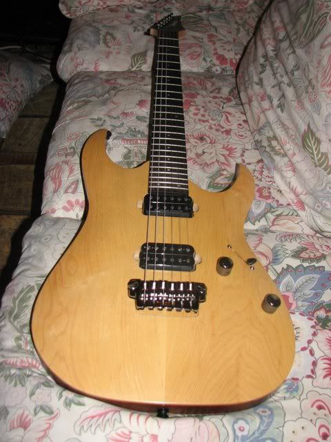

Hi,
I recently bought an used Ibanez RGA121 and it came with a Bare Knuckle pickup, but the seller didn't know anything about it.
So I want to identify it.
It has a DC of 18.14K (8.81K in the slugs bobbin, 9.33K in the screws bobbin), and it has a small (in height) ceramic magnet.
I had been researching http://bareknucklepickups.co.uk and now I think it's a Miracle Man but I'm not sure.
And in the case that it's a Miracle Man how do I know if it's the neck or the bridge model?

I'm pretty sure, but I can be wrong, it's dark gray, almost black, and for me thats the color of ceramic magnets.  But tonight I will take it off the guitar and take a picture and some size measures to have better identifying information.

No it is natural finish, and it's an amazing instrument.  I have two other guitars, both Ibanez, one RG-570, and one S-550, and I like the RGA121 much better. And it is not only because the unidentified BK bridge pickup  :D
