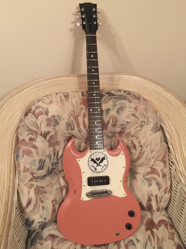

Interesting.  I have had a Graph Tech Resomax NW-2 on my SG Junior since 2014 and have always been happy with it, although it is not that easy to restring (unless you take the bridge off).  The pickup on this guitar is a Stockholm soapbar with 500K pots and a 0.033uF Russian PETP poly cap.  Nut is Graph Tech TUSQ XL and the tuners are Gotoh SG301-MGT with the 05 small pearloid buttons.  E standard tuning wth 9-46 strings but it used to be tuned to D standard with 10-52 strings.  It has adjustable saddles so that's not a problem.

What a cool guitar!  What is the pickup?
I've seen Dave's guitar also, looks like two votes for Graph Tech!
