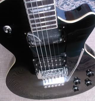

Personally I'm not a Kahler fan - find them too light and often rob a lot of tone and sustain from a guitar IMO
Biggest problem with a Floyd onan LP is the huge wiring run channel that runs deep in the body from toggle switch to control cavity - it's right where you want to put the springs
Obviously Gibson have gotten round this with the Access and Schon models
We have done it before built from scratch - we simply designed a different wire run to avoid getting the springs and cables needing the same chamber
here is a piccy
  • Posts: 3765
  • Truly bad since 1972
Re: Help me out with an idea.
« Reply #20 on: October 13, 2009, 06:30:38 PM »
thats nice
