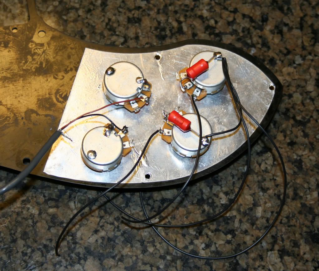

So anyways, do y'all concur that wiper to cap to ground, B to pos on Vol will work the same as;
B to cap to ground, wiper to pos on Vol??
Here's what I got so far following the Seymour Duncan diagram which is different than what I had:
