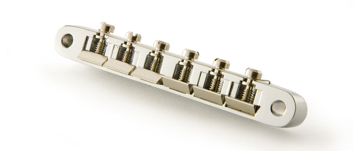

this is an ABR-1
notice it is quite narrow with not much adjustment room and has a wire holding the saddles in place

not the whole bridge - have a look at the first bridge i posted above, notice the saddles face opposite directions.  depending which way they are facing on your bridge you can sometimes flip the saddle for a bit more room
