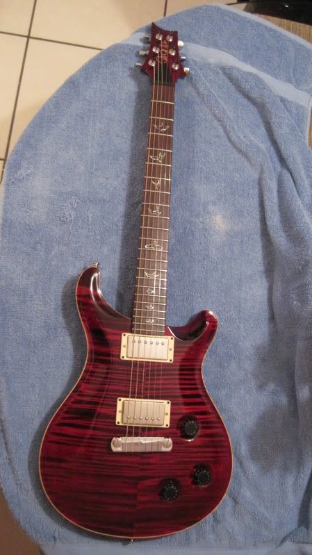

Hey guys I have a couple of Cu22's and want to do a pickup swap to make them sound more different.  I have a MM set in an Agile I barely play so I was thinking of selling the MM set and getting a Rebel Yell set or some Godwoods, but now I am thinking of maybe just throwing the MM set in the PRS. What do you guys think about that? Would I lose a bunch of versatility? Also how would the 5 way rotary work with the MM set, do they split ok? Thanks.
Here is the guitar in question:
