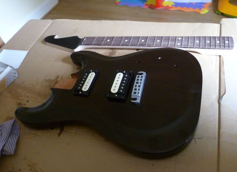

here is a black oil one i am in the process of doing.  wood has been stained black and had a few coats of oil applied
very black
bit of light on it
this is before a more involved process to get the finish exactly as i like it - but it shows the depth of colour/stain well.
