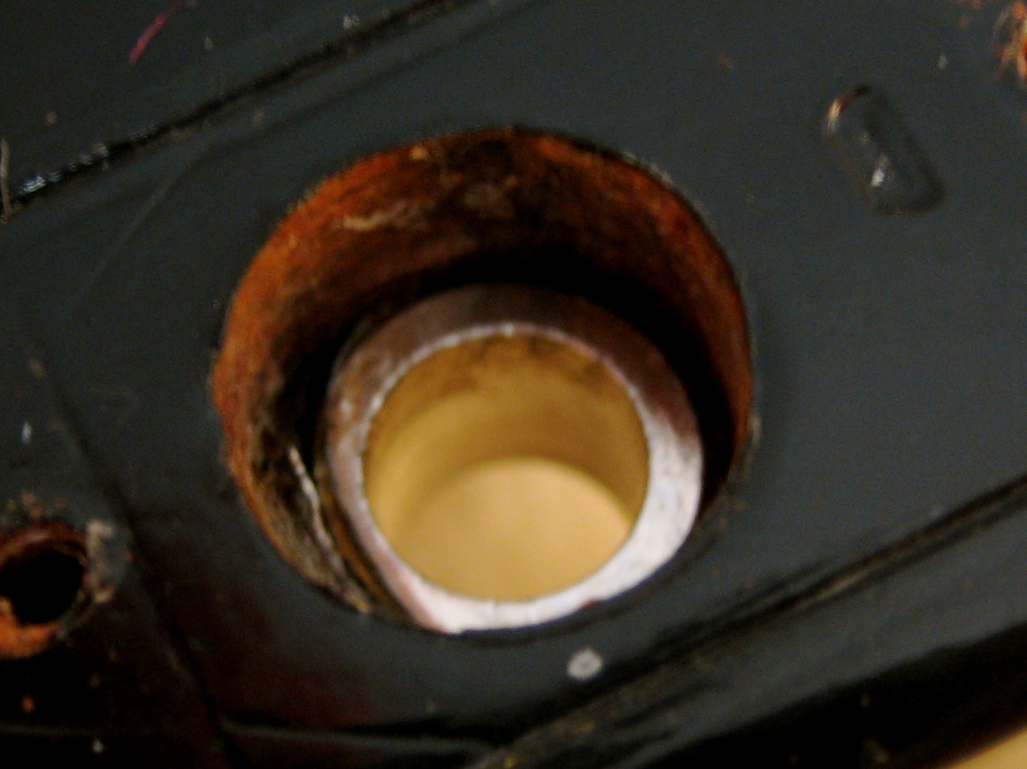

OK, having popped one of the tuners out and measured the hole in the wood on the back of the headstock. I think it's 10mm or maybe even slightly more.  Here's a kinda fuzzy closeup (difficult to hold the camera still! ;) of the hole from the back of the headstock:
You can see the rim of metal down there on the bushing, entering from the top of the headstock.  The actual hole in the bushing for the shaft seems much smaller than the hole in the wood: maybe 6mm.
The bushing seems pretty solidly attached.  No clue whether it's a push-in or screw in! I'm not quite sure how I'd even try to get it out sensibly .... I suppose maybe tap it out very carefully from the back?  Reckon I could put new tuner mechanisms into the existing bushings?
The actual tuner mechanism has "JAPAN" printed on its underside.  This suggests to me that it's a Gotoh Kluson, or a Kluson-style made for Gibson by Gotoh in Japan?

Yeah, I still think that looks like a conversion bushing, and I'm 100% sure it's a push-in one.  Good pics by the way, I can never get my camera to focus for close-ups!  :)
You could definitely put new Kluson-style tuners into the existing bushings.  As I mentioned somewhere above, I found the holes in the conversion bushings a bit oversized for my locking Gotoh SD90s, but I am very fussy about these things. The bushings I have were from Allparts, they're not necessarily exactly the same as yours.
Alternatively, as the holes are 10mm+, you could take out those bushings and the whole world of cast/sealed tuners with screw-in bushings is open to you!
Removing the push-in bushings is usually quite easy.  Gotoh actually supply a special tool, which is a small metal rod, narrower than the hole at the back but wider than the hole in the bushing - you could use an old 8mm drill bit as an alternative.  Then just place the tool/bit against the base of the bushing from the back of the headstock, and tap (very lightly!) with a hammer.  Once the bushing starts to move, it usually comes out really easily.
The only problem could be if the previous owner decided to go a bit over the top and glue the bushings in - they don't normally need it, but you never know.  Then it might be best to leave them, or take the guitar to a pro...
