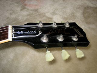

I'm pretty sure one of the original machine heads (the G-string one) on my 1990 Gibson Les Paul Standard is a bit screwed.  That machine broke on me when I was in the UK in the late-90s; I had it repaired once in 2000 in the US when I was back in Boston for a while, and again in the UK 2006 when I noticed it was acting wonky again.  In both cases, I trusted the luthiers' assertion they could fix the given machine head without replacing it, though in both cases, whatever fix they made "degraded" over time.  I think there's just something fundamentally screwed with it and it should just be replaced.  When the string tension is slackened, it actually wobbles a bit, which is rather alarming. In case you have lots of time on your hands ;) there is a little diagnostic video here: http://www.carlaz.com/music/images/headstock_peg_wobble.avi
This time, I think I'd best do the work myself -- mostly because I'm in Colombia :) and while there are likely to be some decent luthiers in Bogotá, I have no idea who they are!  So I'm thinking I should just order some "drop-in" style replacement machine heads to my US mailing address so I can pick them up next time I'm up there.  I really don't want to get into trying to enlarge the holes for the machine heads on my own!
I think I've got "Kluson-style" machine heads, but here are some (still) images:
So I'm interested to know what you BKP users think are the best-quality replacement machine heads that could directly replace my stock ones without serious surgery? :)
I understand Gotoh make some Kluson-style locking tuners that can go in without re-drilling, and that sounds good to me, but I've got almost zero expertise on this stuff!  I'm not too worried about the "look", just the quality -- and straightforward install. ;)  If folks think Grover make better drop-in tuners than the Gotoh Klusion-styles, then I'm cool with that!

Hard to tell from the pic - are the bushings the press-in type or the screw-in type?  Modern Gibson Kluson-style tuners are usually the latter, but I don't know what they were using in 1990 (assuming they're the original tuners?).
If they're press-in, I'd go for Gotoh SD90 Magnum Locks.  If they're screw-in, TonePros Klusons.  :D

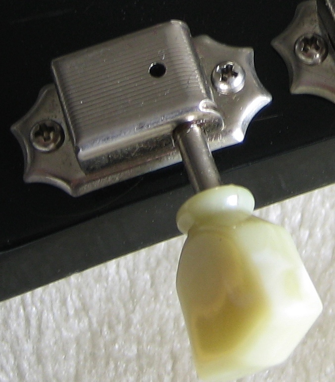

Can you do a pic of the front of the tuner?  The screw-in type will have a hexagonal nut with a washer under it, the push-in type will just be a ring surrounding the tuner post.
Those look vintage-style to me, Gotohs or similar.  So they're probably press-in bushings with 11/32" holes.  If that's the case, you could go for Gotoh SD90-MG (locking) or SD90 (non-locking), or TonePros Kluson TPK33 (non-locking).
But let's see the front of the tuners first!  :wink:

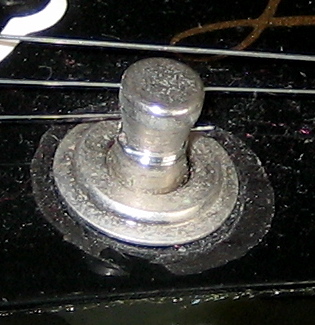

Yeah, I'm not seeing anything that looks like a hexagonal nut with a washer underneath. It looks to me like a ring around the post (though the inside of the ring next to the post is raised more, and there's a flatter flange on the outside of the ring further from the post, but it all looks like a single piece to me; I can't see any crack or line between the two "heights" in the ring).
So you're probably right about the press-in bushing ....

That looks to me like a conversion bushing.  It's where someone has decided they'd prefer vintage-style tuners on a guitar with 25/64" (10mm) holes in the headstock.  So you can buy oversized press-in bushings to fit the 25/64" holes.
I'd guess the ring of greyish-looking paint around the bushing is where the finish is lifting a little?  That'll be where the washer sat when the guitar had screw-plus-washer bushings.
So, you could use Gotoh SD90s (locking or non-locking) with the existing bushings, but I've found that the holes in conversion bushings are a little oversized for the Gotohs (they'll work, but it looks ugly).
Your best bet is probably TonePros with screw-in bushings, the TPKB3 or TPKB3L sets.  I haven't tried them yet but I hear they're very good.
Of course with 25/64" holes you could go for Grovers, Sperzels or whatever you want.  But the TonePros will keep the more vintage look.
But I'd take a tuner off and measure the hole at the back first.

Hmm, yeah, I'd never really paid attention before, but there's a pretty regular ring-like bit of damage to the finish around each of the shafts of the top-side of the headstock.  Once-upon-a-time larger washers seem likely. I got the guitar in '94. I think, and the serial number tells me it's a '92; I had assumed it had stock tuners -- but I guess I was wrong about that, too!
Most educational ....
